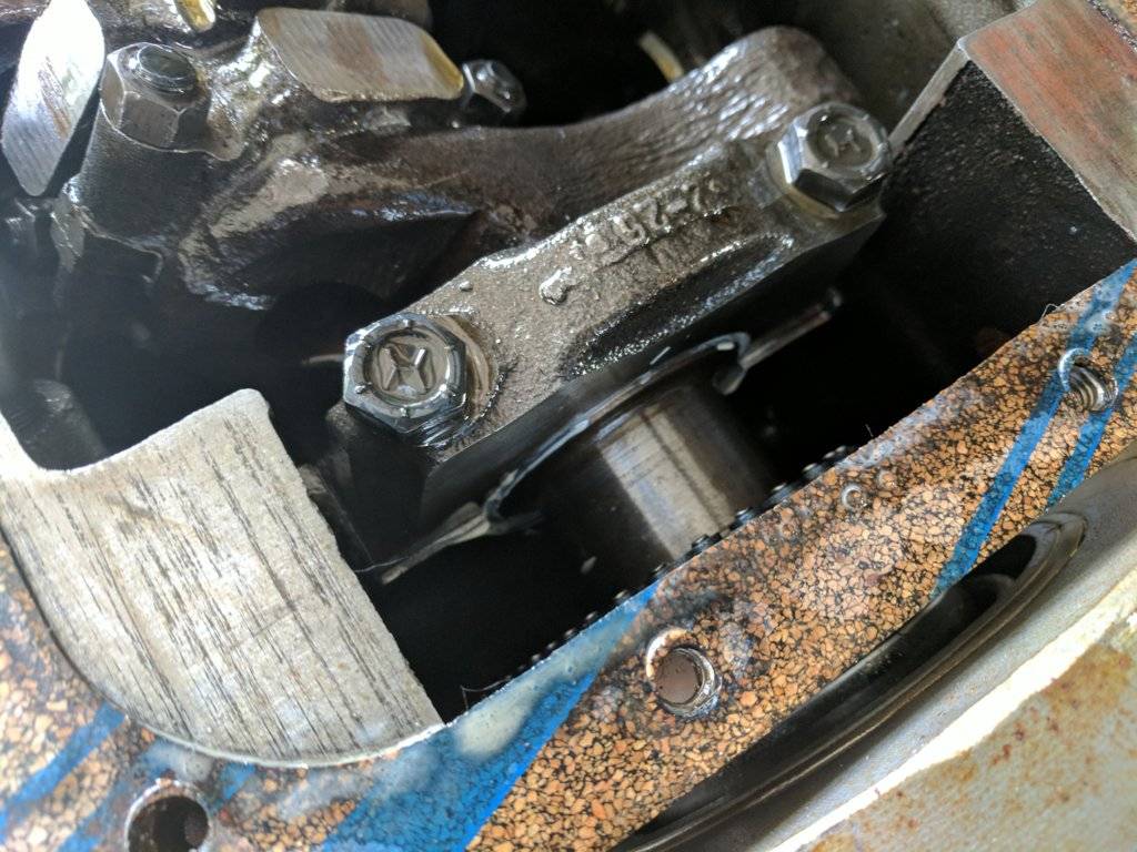

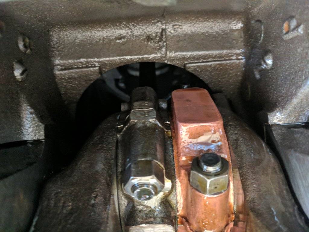

Some water got in the 413 I picked up to use as a set up engine for my Dart. The crappy part about having a tiny garage, full storage and a host needing a fluid swap.

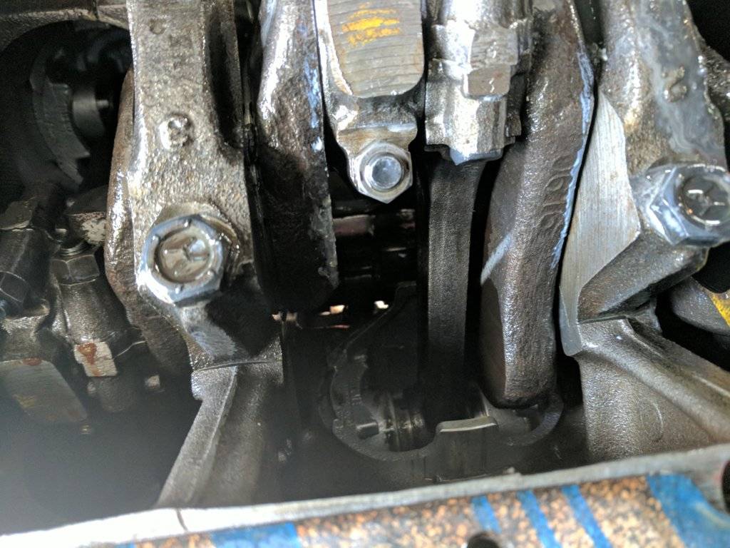

The back story, the engine was built, assembly lube used judiciously, break in oil with zinc additive, started and ran for a few minutes "to see how it sounded" then shut off. That was 3 years ago. I got it not too long ago and had it covered in the back if my truck. It was dry up til last week. Went to get the engine out as I had fixed the hoist. I noticed a small tear and knew I was going to see water when I dumped the oil. Yep, but it looked like when coolant was in the oil, that lighter brown crap. I figure it might be that break in oil, or assembly lube. Not sure, that was the least of my concerns. Well today is 2 days later and my friend had an engine stand freed up so.i borrowed it. I took the oil pan off and it wasn't as bad as I thought it might be, hut one rod is brown as my last name is. Everything else looks pretty good considering there was at least 1 & 1/2 gallons of water, yep! There is only very slight surface rust on the counterweights. Input some oil back down the valley when I dumped the old crap. Definitely keeping it "wet" so it doesn't flash rust. Gotta sleep some before work, but aside from dumping oil down the valley and trying to get all I can wet with oil, should I do anything else? I might just go crazy this weekend and try to stuff this pig in the car to get it started if it's not toast.
I did turn the engine over and didn't notice any drag like with a rusty crank, but it was just after the oil was drained. It felt nice and tight like when I first picked it up, turns over freely, but firmly until the cylinder pressure bleeds off.
I don't know man, I'm usually a very paranoid person about stuff like this but .. if that thing only ran a few minutes and was assembled with a ton of assembly lube, that lube is still protecting you bearing surfaces, timing set and whatever else it was used on. Getting as much of the contaminated oil out is paramount BUT, if you keep it from flash rusting (which I doubt it will if you've dumped a bunch o erl in there) I'd put it back together, drop it in the car, fill it with oil, prime the hell out of it and fire it.
I would suggest pulling the rod cap from the one rod that is discolored. That type of discoloration could also have been from an overheated bearing. Better to check it than be sorry later.

I totally agree Dave, Look at the rod and cap if all looks good, fill it with new oil and prime the heck out of it. Them change the oil and filter. Oil is cheep, a rebuild on a new engine is not.

A rust color from overheating? I've seem the rainbow effect of heat when the oil pump fails.
Good point, guys. I Kinda overlooked the brown rod (giggity).
Scott, No not rust colored from overheating, but to make sure their was no water damage on the rod and bearing at the crank.
Still a bit odd that only one rod was rust colored, wondered if that was a new replacement? Still best to check it. Have seen the rust color on engines that have "blown" Metal has all the oil burned off due to heating and then when a rod makes an inspection hole in a water jacket someplace, flash rusting follows.

Like all the other guy's have said, check the rod, clean out all the old oil/water mix, fresh oil & filter, prelube, install and light it off.
no rust there bud , plastic gauge the bearings to know were its at . peel it , rings n bearings polish the crank with fine emory cloth (400-600) and oil . clean n assemble , plastic gauge check the bearings clearances , lose will rpm . and rods turn bluish brown to dark blue from no oiling . that one rod looks like it was primed coated paint for oil run off . guys would do the whole inside of their blocks to help the oil run back to the pan faster . but it doesn't get a chance to carry the heat from the motor with it coated , would be better off with a crank wiper to break the oil rope that wraps the crank n rods during rpm operation . and polishing all that move mass can't hurt either . polished connecting rods and crank on all surfaces make the oil leave it easier taking the heat with it , all home stuff , you can do it a shed . or like my bud did as a kid . used knife stones down to honing clay to polish his crank n rods in his living room watching gilligin's inland ect ..... he buzz'd that thing 8k with good pistons and heads , and a monster cam gear , never had an bearing or rod issue with it . turn a all steel 63 fury in the 10's with one 850cfm holley on it . that was a budget build too .
The con rod that has the different colour to it (rod # 7) is actually a copper coating applied to it during the sizing of the journal procedure. If the rod is not within size tolerances it is dipped in copper and resizing attempted again. Nothing wrong with it just looks odd. I encounter this often and can show pictures if interested . Anyway, do the flush and spin just like what everyone said above.
Thats a great bit of info! I was thinking that the uniformity of color made little sense as rust .. too that there was nothing on the rod next to it.
