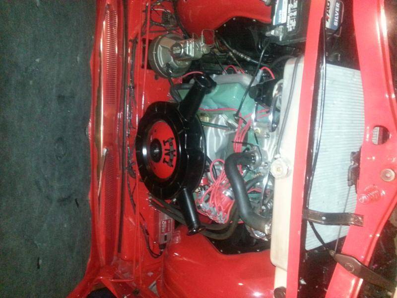

I installed aftermarket AC in my 70 300 w/440. After a lot of adapting (I think the kits are made for B bodies) the install is not too satisfactory. They did change over my non-AC controls to work, that part looks stock. The AC cars have the 26" radiator with a passenger side upper hose outlet. The non-Ac cars apparently have the 22" rad with driver side hose outlet. The compressor in this case mounts on the driver side and interferes with the hose. I had to lower the compressor as far as possible and the belt now has minimum engagement and squeals. I am hunting for a way to convert the 22" radiator to a passenger side hose outlet so the compressor can be raised up to a normal height and get about 6" of belt engagement.
