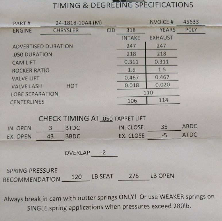

Thanks...the cam is part of my upgrade project that started with installing a 600 CFM Edelbrock 4 bbl carb on a factory cast iron manifold. Since I'm going to be in there already, a new timing chain is also part of the project. Cam spec sheet attached...I was looking for best overall performance increase without losing a lot of low end power. Should make the dual exhaust note slightly more aggressive too.
I don't have 318 stock cam spec's available. But looking at those numbers makes me think you bought a smaller cam. For one thing, Mopar durations & lifts are different. You need to STOP immediately and research this out before you go any further! For a stock cam replacement cam wanting a small boost? I would not use this cam for that!
I ended up going for this particular grind as I didn't want to give up a tremendous amount of power down low or lose alot of vacuum but wanted to increase power as much across the board as I could while providing a slightly more aggressive idle. This will be for street use only. I was told by the company that made it that it was the grind they used most often for 318 poly street driven cars. There are few places that make cams for the poly and these guys seem pretty familiar with it so I went with their recommendation...

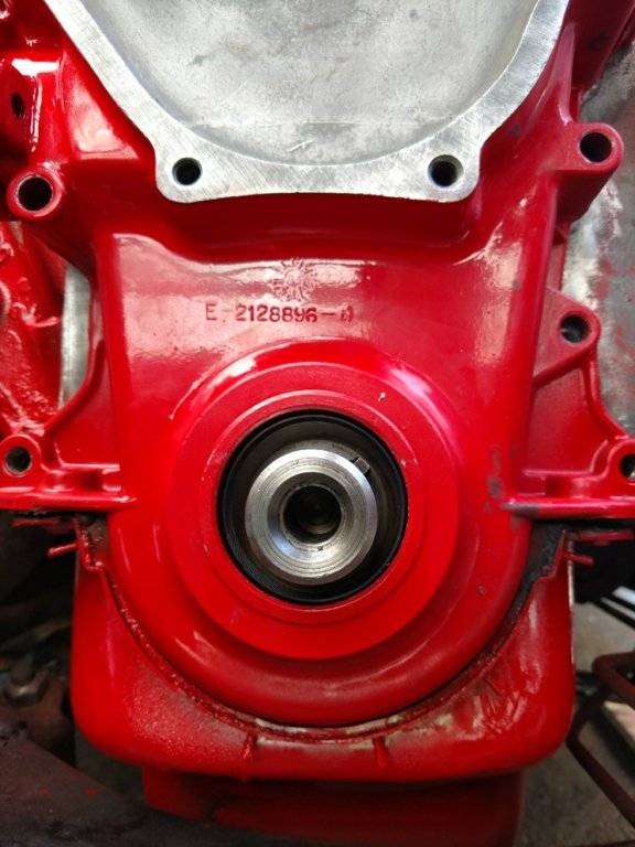

I've run into an issue trying to reinstall the timing cover and hope someone has some advice on this. I'm using a Felpro timing seal set and will now have to strip it all off cause I screwed it up the first time! First, I used permatex high tack to adhere the timing cover gasket to the back of timing cover. I also installed the rubber front pan sealing lip gasket with Permatex ultra black top and bottom and for added security, put a thin coat of it around the coolant passages. So far so good....next I cut the little front pan corner cork gaskets to size and stuck them to the top of the pan with the Permatex- top and bottom.
After all this I tried to install the timing cover itself. It was a little rough initially getting it to clear the rubber oil pan lip without knocking it out of place. Finally got it right and pressed the cover up to the block and started to (try) to get some bolts put in...I couldn't press the cover low enough on top of that fresh thick pan gasket lip to get bolts to thread properly. I tried to install the two bolts that mount "up" through the bottom of the front of the oil pan thinking they would pull the cover down but those were the only bolts I could get to line up and get in. Of course during all this time the Permatex ultra black set up nicely enough that I couldn't move the cover without breaking the seal! I tried using some long philips screwdrivers to slide the cover sideways and up and down but to no avail. I got close to getting a few bolts in but they weren't going in straight enough and I was afraid to crossthread them so I stopped.
Bottom line- what is the easiest way to get this thing lined up properly and bolts threaded before the Permatex sets up??...which bolts do you put in first and in what order to expedite? Part of the problem seems to be that the lower pan lip gasket is new and thick and I can't push down on the timing cover and compress the rubber gasket enough to get the bolts to line up...

I tried that at the end of my aborted attempt but it was too late and the Permatex had dried too much to move it without breaking the seal...I ordered a new seal kit and will reattempt when it arrives but wanted to know what the correct order of sequence is? Am I using the correct adhesives in the correct places? Surprised me that it set up so quickly... probably didn't help that I'm doing the job in the driveway and it was 95 degree today...
I've had a chance to look over my work again without any fear of drying Permatex...it seems that the rubber seal for the front of the pan is too thick. I took out the side corks and even trimmed the outer ends of the rubber seal down and the cover will not go low enough...and yes I've even tried standing on the top of the timing cover to press it down and it won't compress the seal enough! I've taken a picture of the cover installed on the front of the engine (not bolted) and you can clearly see that the crank is much closer to the crank hole towards the bottom than the top...the harmonic balancer clearly will not slide in there properly....now what?...get a new gasket and sand it down so it's thinner??

#1 you don't have the timing cover bolts in, #2 do not sand/trim rubber oil pan gasket.
When Dave said loosen front oil pan bolts well it's more like all the oil pan bolt except for the 2 rear ones.
What you want here is to drop the front of the pan 1/2 a inch or so, put the oil pan rubber front gasket & side (tabs) in, gasket goo the corners, then install the timing cover, hand tighten timing cover bolts up making sure it's in 'proper', ie all bolts should screw in by hand tight, then torque it, don't remember if there is any aligning dowel pins on timing cover, but with all the timing cover bolts seated hand tight the timing cover will find it's proper alignment.
Then re-tighten your pan bolts to snug up/crush the front oil pan gasket. This can be all done fairly quick as you don't want the gasket goo to set/harden. Really not that hard, if your really paranoid about oil leaks you can pull the oil pan and replace the whole side gaskets but that's a whole bit of another fun with the engine in the car.
I seem to remember that some timing cover gasket kits came with two front rubber gaskets big/small on some applications, truck pan vs passenger car, GM vs Ford, vs Mopar, can't remember been years, compare what you take out to what is going in, or better yet read the little instruction paper that should be with the gasket set.
