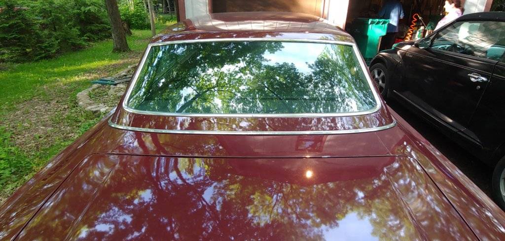

The lower piece of trim under the window what kind of trim clips does it take, and what kind of tool to pop it off. Going to try to find where the water leaking into at so i can figure how to fix the issue myself :-\
The lower window trim? Or the trim below the lower window trim?

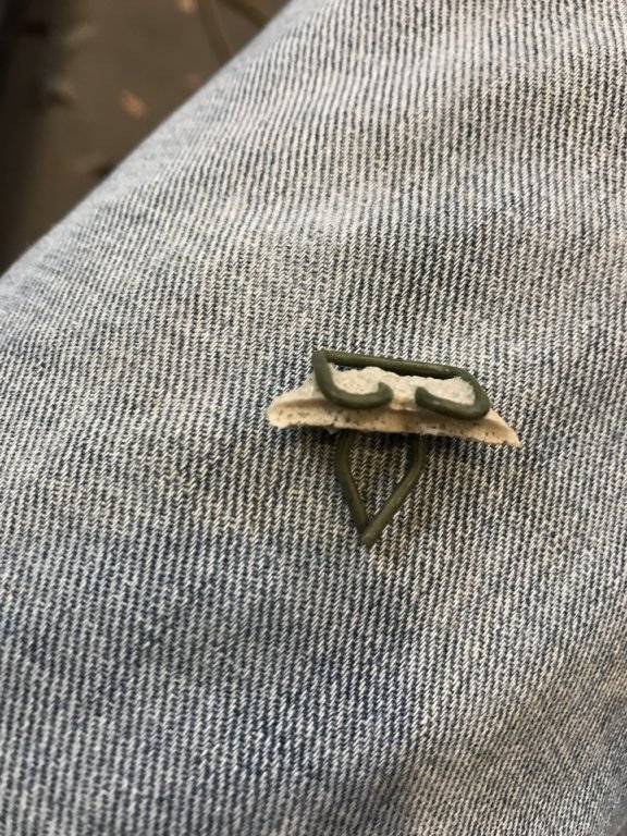

The lowest trim that wraps around the side and rear most likely has some spring clips and a couple of anchors clips that you will have to take the nuts off of in your trunk. On my ‘68 Polara 2dr. The spring clips were similar to this.

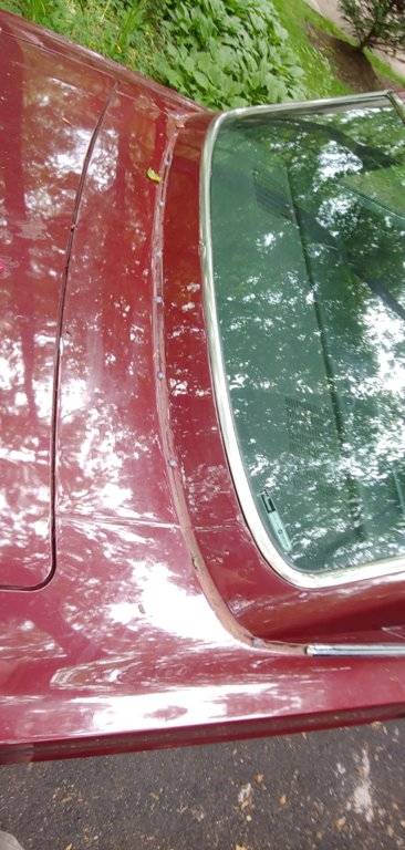

It's not the trim around the window that was "fixed" about 3 years ago
Did not know about the gaskets on the clips anything special about the gasket material? I'm gathering my information before i tackle anything first
The "gasket material" is a part of the clip, not a separate piece. Usually was a light green sponge rubber, as I recall. What's pictured is similar to what I suspected it might be. There might have been a few different types, though? For the color/vinyl roof divider molding, which is below the rear window surround molding.

Found the hold down nuts, what kind of tool do i need to pop off the trim, i don't want to man handle it and damage it. I did see two different styles of clips on the parts book. This will be something for me to do after my floor pans get welded in

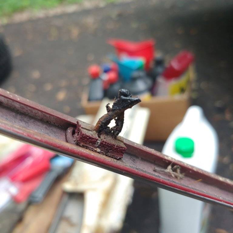

Managed to pop it off... The seal/gasket died with age

Found out yesterday, it's a total of 4 nuts i had to remove and 7 clips, only removed two nuts and broke two of the plastic hold downs cause i didn't notice those at the time *yikes* *sigh* time to find some of those used hold downs
