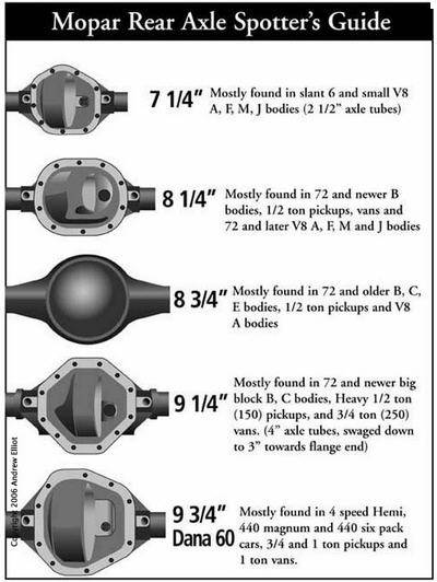

Wishing to purchase a "Locker Pumpkin" from Jegs for my vehicle, but there are many that may fit dependent on outer size (8.25?) spline number, axle size, etc
It may already have a limited, coz sometimes she'll may two nice big lines, others single ?
Does anyone know which of Jegs offerings (or if you know better, cheaper to buy)
Remembering I'm in Australia - so DO NOT want to get this wrong and re-ship (HUGE $)
Any help GREATLY appreciated
Big Jim - Adelaide, South Australia
Wouldn't there be a SureGrip option code on the data plate? There should be a metal tag on the axle with the 2.7_ ratio on it, too? NO secrets about these things with the Chrysler data plate and/or build sheet!

Locally I've been told its an 8.25 diff - which would struggle if engine output is correct / also told its a Banjo and Dana 60 = so what the "Beep" is it
MANY THANKS to "78Polara383" for the detailed schematic - jeepers the times I couldda used that in my life (running Mopars)
