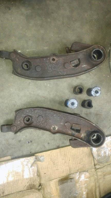

I was referring to the photo of the arms with the bushings removed which I thought were yours...
These ones are chewed up pretty badly having been removed.

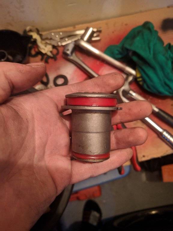

Well, they fit! but oh boy, getting the inner sleeve and the rubber out of the old bushings with the contol arm just unhooked from the frame is a *****! I will most definitely take the UCA out for the other side. Once set up with the balljoint press, its easy to push the inner sleeve out and just use a screwdriver to pop out the rubber.
hmmmm so interesting, the bushings on the other side are vulcanized onto the sleeves. the other ones just popped out!? How weird is that, they are the same Moog parts.

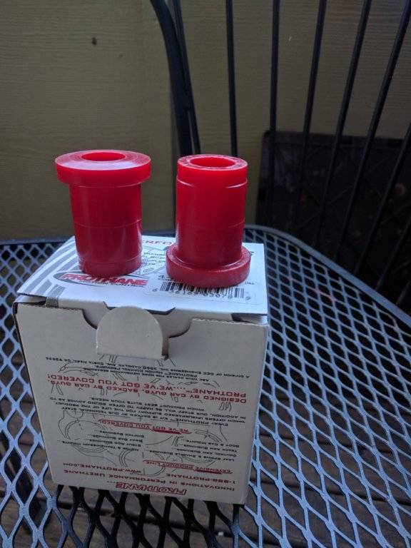

Just got done getting all the rubber cleaned off from the metal parts and installed the Poly insert. It really wasnt that difficult, I just wish I they could have been submerged in some sort of solvent that disintegrates the rubber...

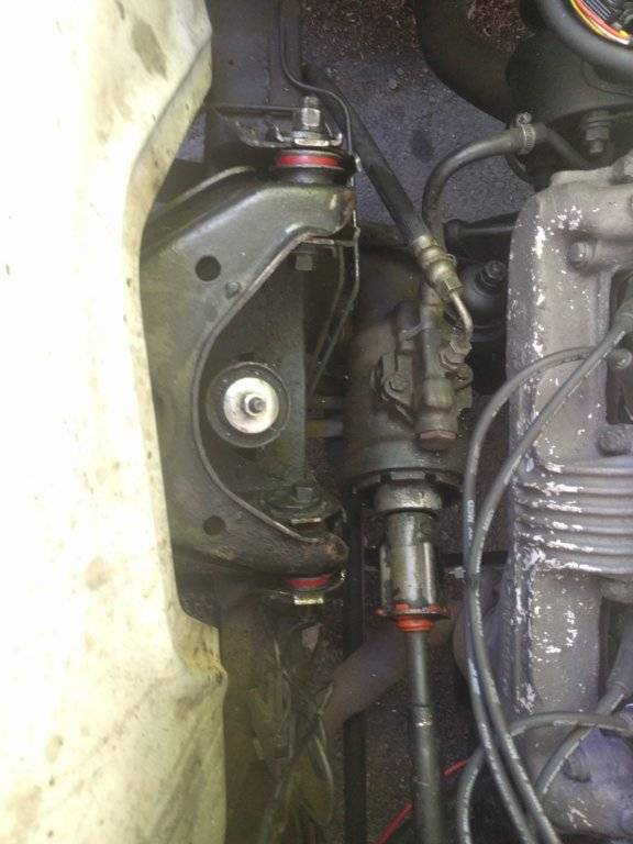

Btw I have no increased noise or squeaking, so far they do fine. I have some softer poly on the strutrods too. The frontend seems a little tighter at least.
