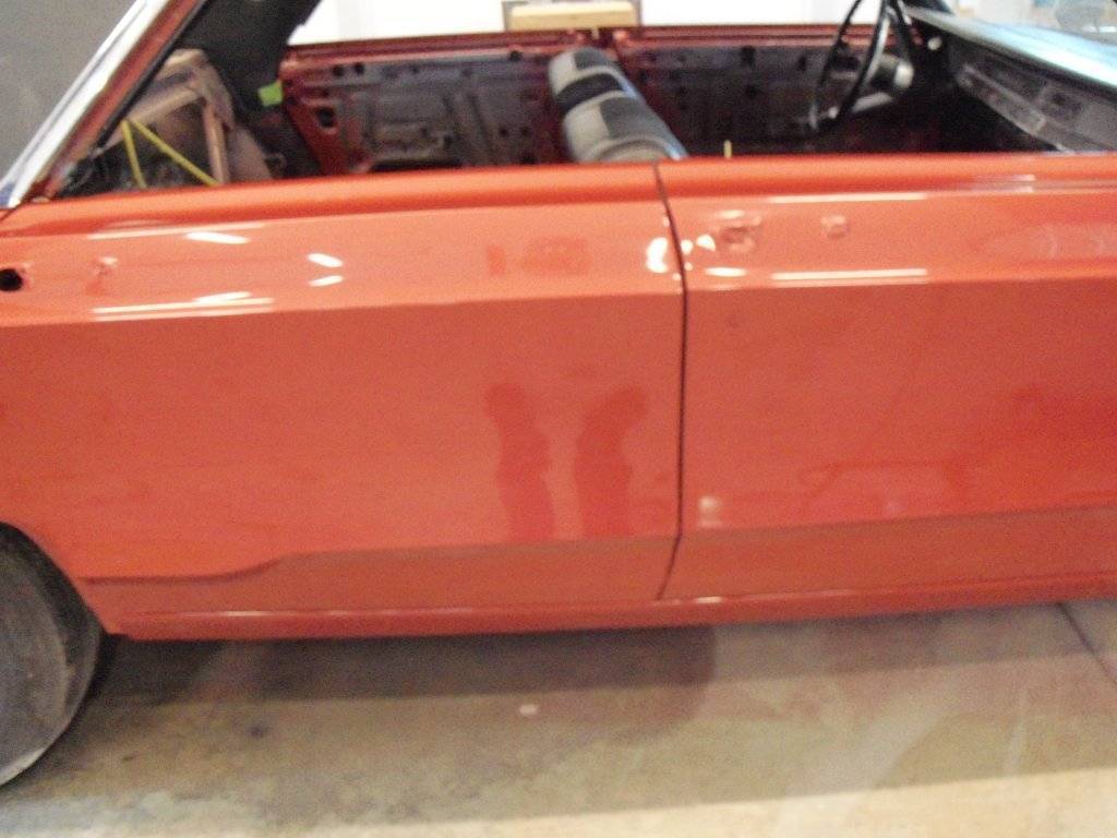

Ok.. my 68 Newport has a vinyl top, so the roof was not painted.
But the hood and trunk were painted off the car in the booth.
I gave my painter a car done in primer.
I chose base/ clear.
1.6 gallons of paint that included all door jams, the insides of the hood ,trunk and doors.
2 gallons of clear ( 4 coats with 1 coat lost to cutting and buffing.)
My painter used a Dupont second line paint.
ANy metallic paint is not cheap so be prepared to pay.
