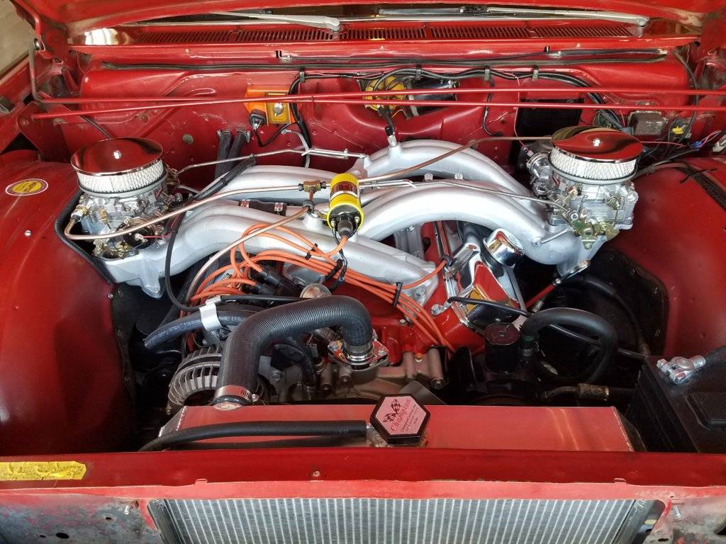

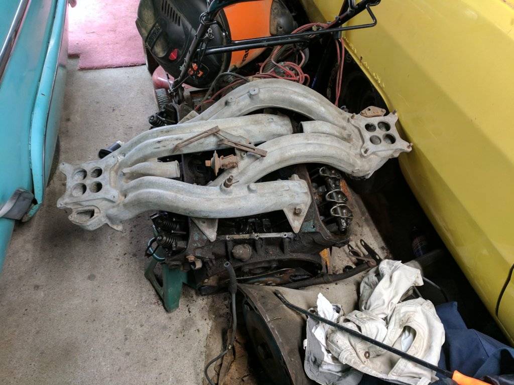

This a ram set up on my 66 Newport 383. I used 1406 Edelbrock carbs with electric chokes and it runs great! Be aware that these will not fit under every cars hood. I had to clearance the right fendereell to gain enough room for the intake.

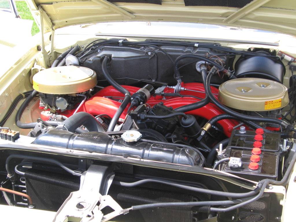

Here's an original '60 300F with the crossram.

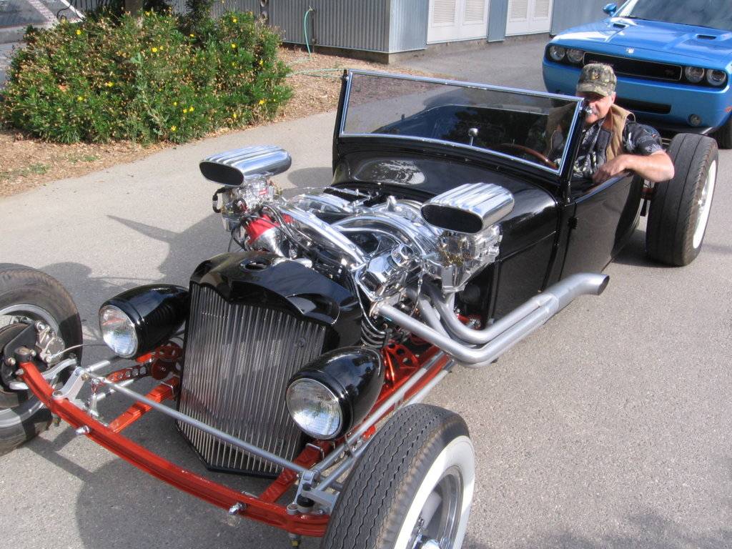

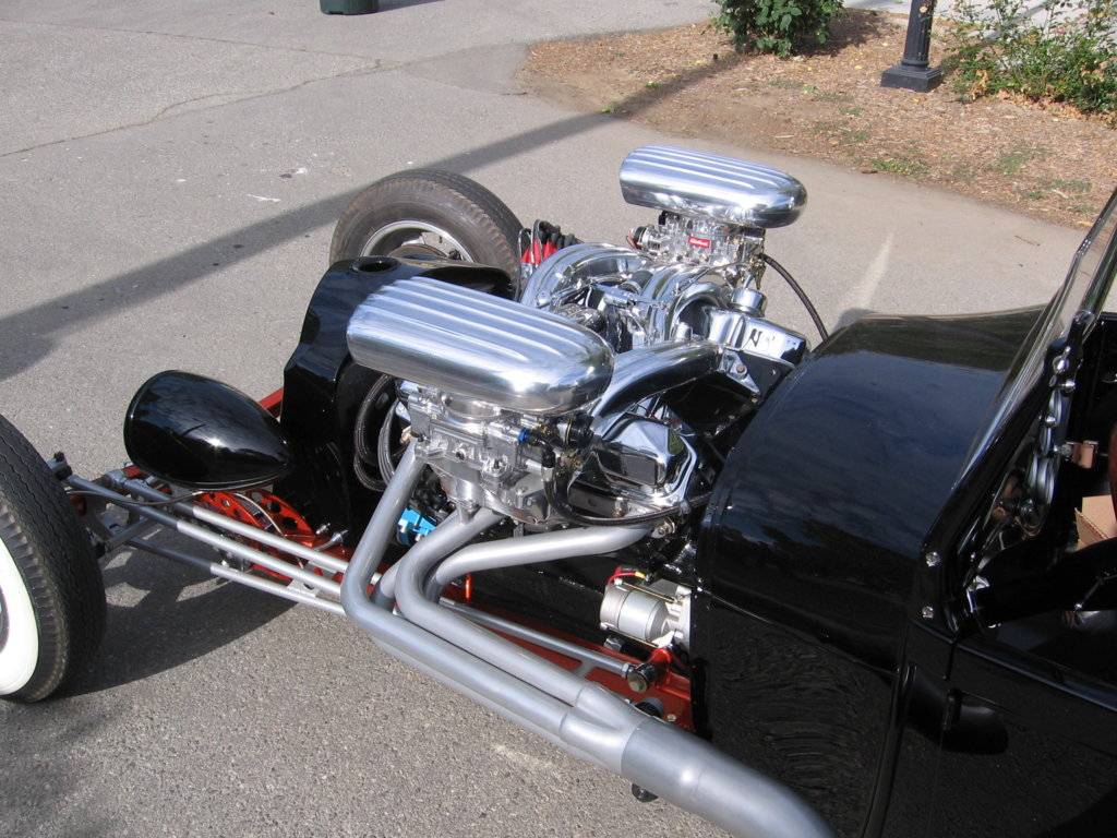

Here is perhaps the best use of one I have ever seen. Motor was a 413 and the car was totally cool!

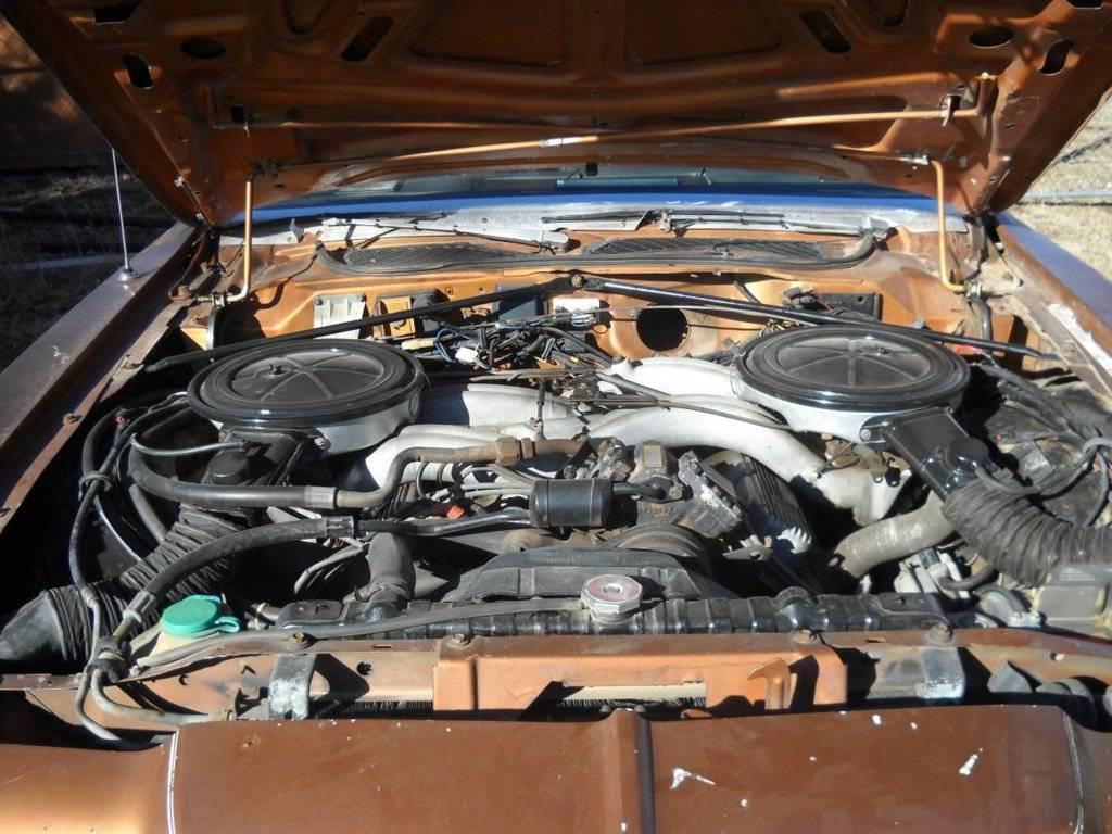

Some time ago a link was posted on this site for a (Cordoba?Magnum?) that was for sale. It had been modified with this intake setup...I saved a picture.

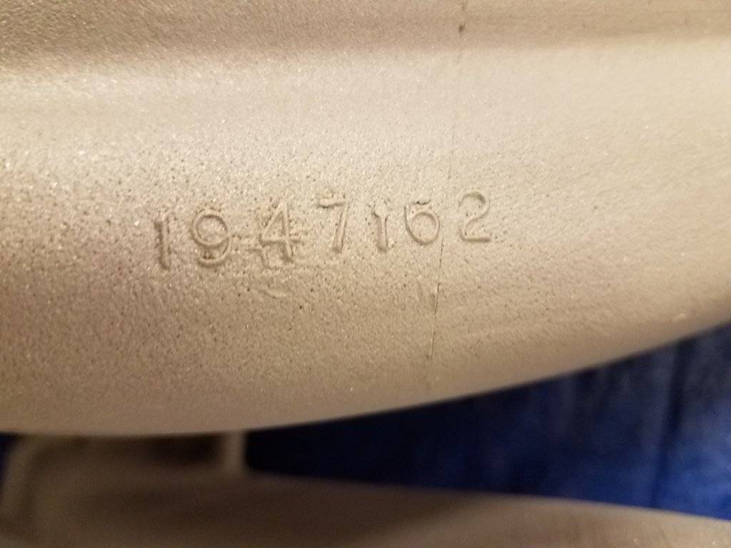

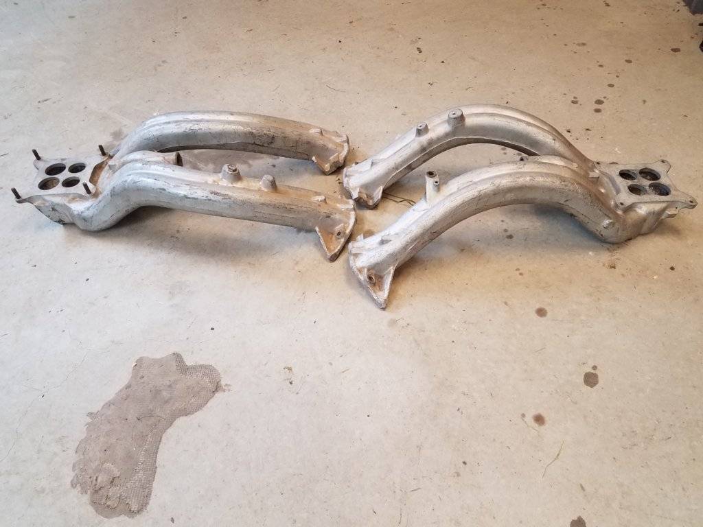

I got a set of these intakes, and yes, they are missing everything. There are always a few sets being sold it seems, and complete sets with everything aren't cheap. Mine might make it onto a vehicle someday, til then, they are a conversation piece.
You might want to look for manufacturer part/casting numbers, for the sake of authentication. I think the vintage items would be square bore, unless yours have been modified.
Thats a very good point! I've seen a number of these rams that have been modified. Choke wells and or the exhaust heat passages cut off, or the carb flange bores removed. At that point to me they're not as cool and the value is gone. Not sure abt the functionality after mods either.
I know mine are stock, but only found a casting number on one. Not modified at all.
You'll only find one casting number. I believe its because they are one manifold....although being two parts....I know it can be confusing!!
All the sets I have or have seen has just the one number on them.
