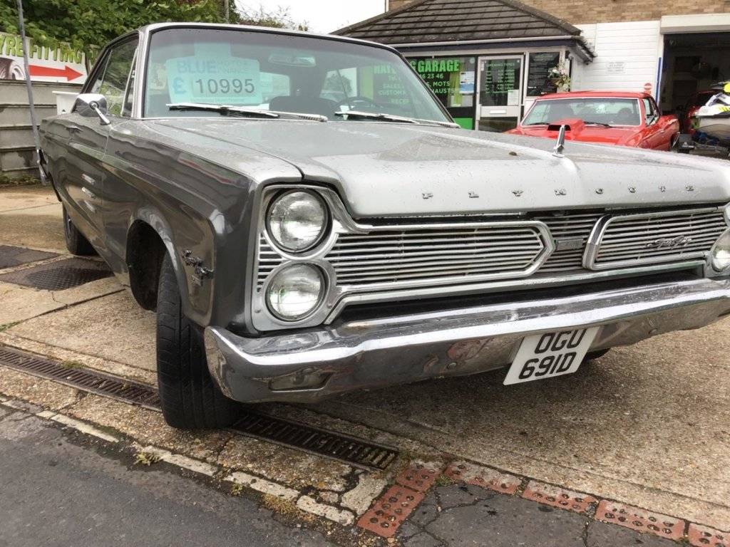

is a '66 2 door hard top, with a 440 and a four speed? [see pics in my garage section....] especially in the UK!
It's not matching numbers.........but, too be quite honest, over here that doesn't seem to mean as much as it does in the US

Cool find. Do we know for sure it was a factory 440 four?
I don’t think the production numbers for 66 C bodies are known making the proper answer “not many”.
Since 66s don’t have VIN stamps on the enigine and transmission, they can’t be numbers matching
Congrats!! Have fun with it, numbers matching doesn't matter. A 440 4spd C body is cool regardless!!
For your own curiosity, you can check the machined pad opposite the distributor on the driver's side. If the car has a B-440 stamped on the pad, it has a '66 440 engine. You can also decode the build tag as that will give the original engine and transmission. '66 model year cars did not have the VIN number stamped on the engine or transmission, so there is no "numbers matching" as noted. Some one has already done the split brake conversion. Looks like a nice find and should be a nice driver as well. The base of the hood ornament usually had the original engine size embossed on it as well

As noted, there aren't any "numbers" to match on these cars . . . as there are on the later models. About as close as you can get is to look at the casting date for the engine block. It should pre-date the assembly date of the car by up to 6 months.
I'd be more concerned if the 4-speed transmission was assembly line installed. If not, then the quality of the conversion might be an issue. But as long as it works, ENJOY!

Congratulations. Nice find. I think 66 was the first year for 440 so it might be factory original. More common is the 383/4spd combo. Some here know these cars very well and can give you a much better answer.
Nice car. The combination was definitely available. Factory equipped with a 440 and 4 speed it's quite rare - according to various pundits there were perhaps less than 1500 made with 383 & 4 speed, and less than 500 with 440 & 4 speed, going with a generally accepted ratio of 1/10th of 1 percent of total model production.

I'll have a closer inspection when it arrives.......suspect engine is from a later car..........
VIN number is PP23966156586, engine number on reg doc is 398830440.......which seems to suggest it was originally a 383.........the second number makes no sense at all.....will have a closer look when the car arrives.......
It looks like a typo of the casting number, with a 6 missing between the 3 and 9. That would then be a '72 - '78 440 block
