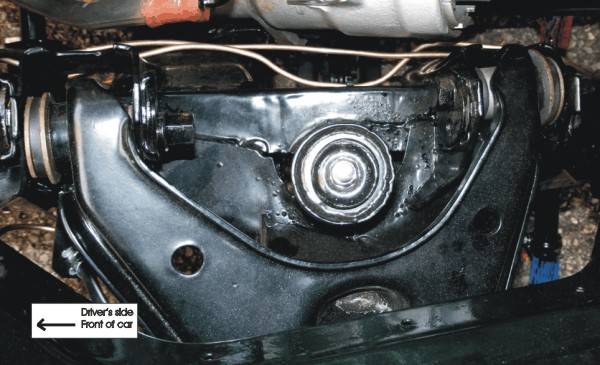

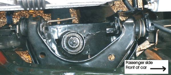

The story so far, here's how the upper arms look:
So upper ball joints are pushed as far rear-ward as possible, to give the most positive caster. The '67 Monaco/Polara service manual calls for 0 to -1 degrees of caster (for manual steering) and .25 to 1.25 of positive caster for power steering. I don't know what the camber is, and I haven't measured or adjusted toe.
