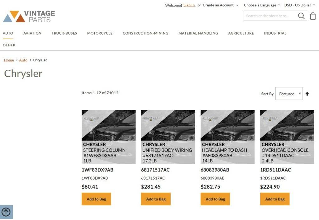

For parts that fit vehicles from the 1990's to fairly recently, you want to also check out Vintage Parts. They buy out all the old inventory from Chrysler and a number of other manufacturers. I believe that once you set up an account, you can buy parts directly from them. If you know someone at a Chrysler dealer, you can order through the dealer. Vintage Parts will sell to the dealer at the last wholesale price that the part sold for when it was discontinued. I think they cost more if you go direct.
Jeff
