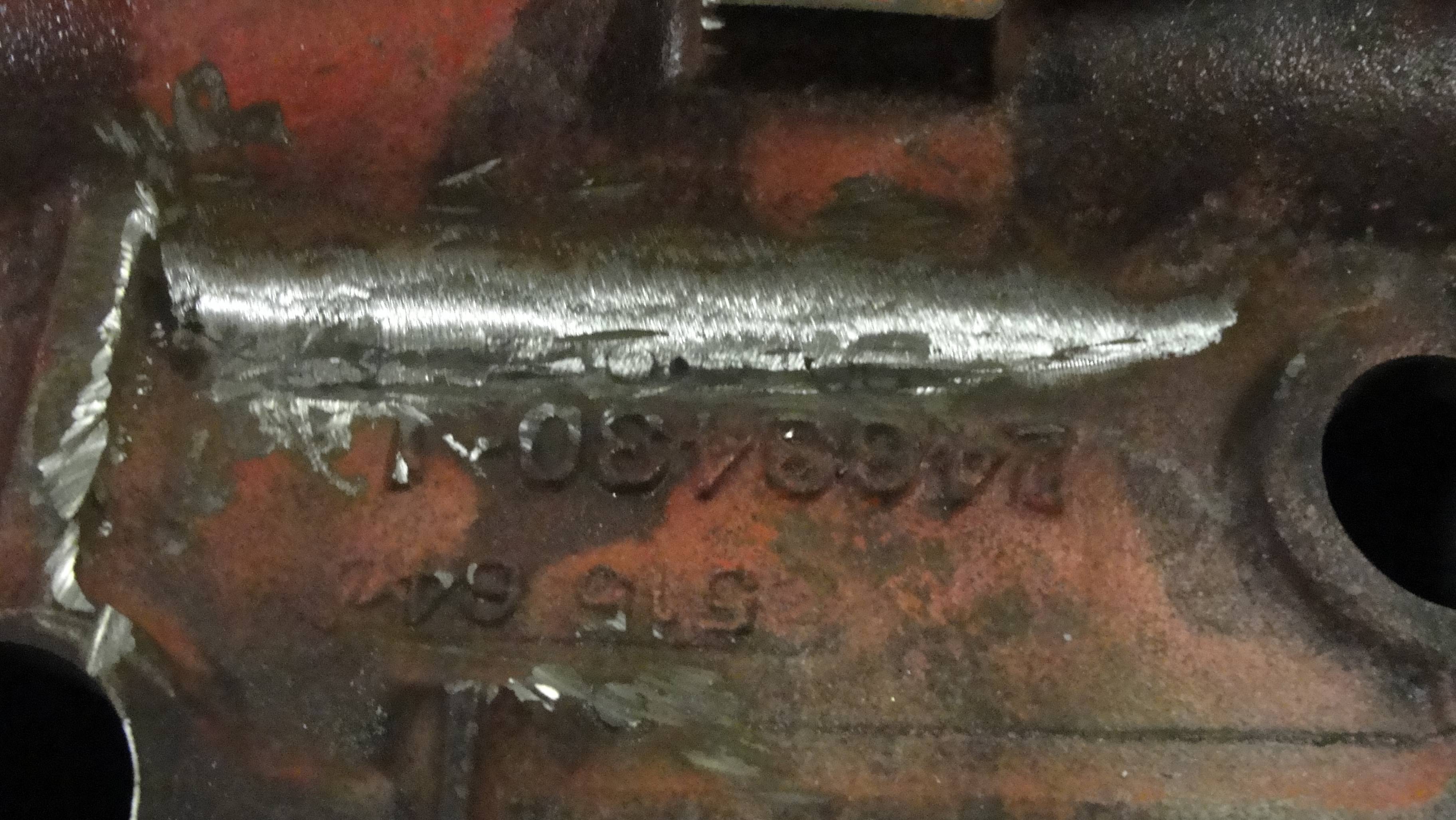

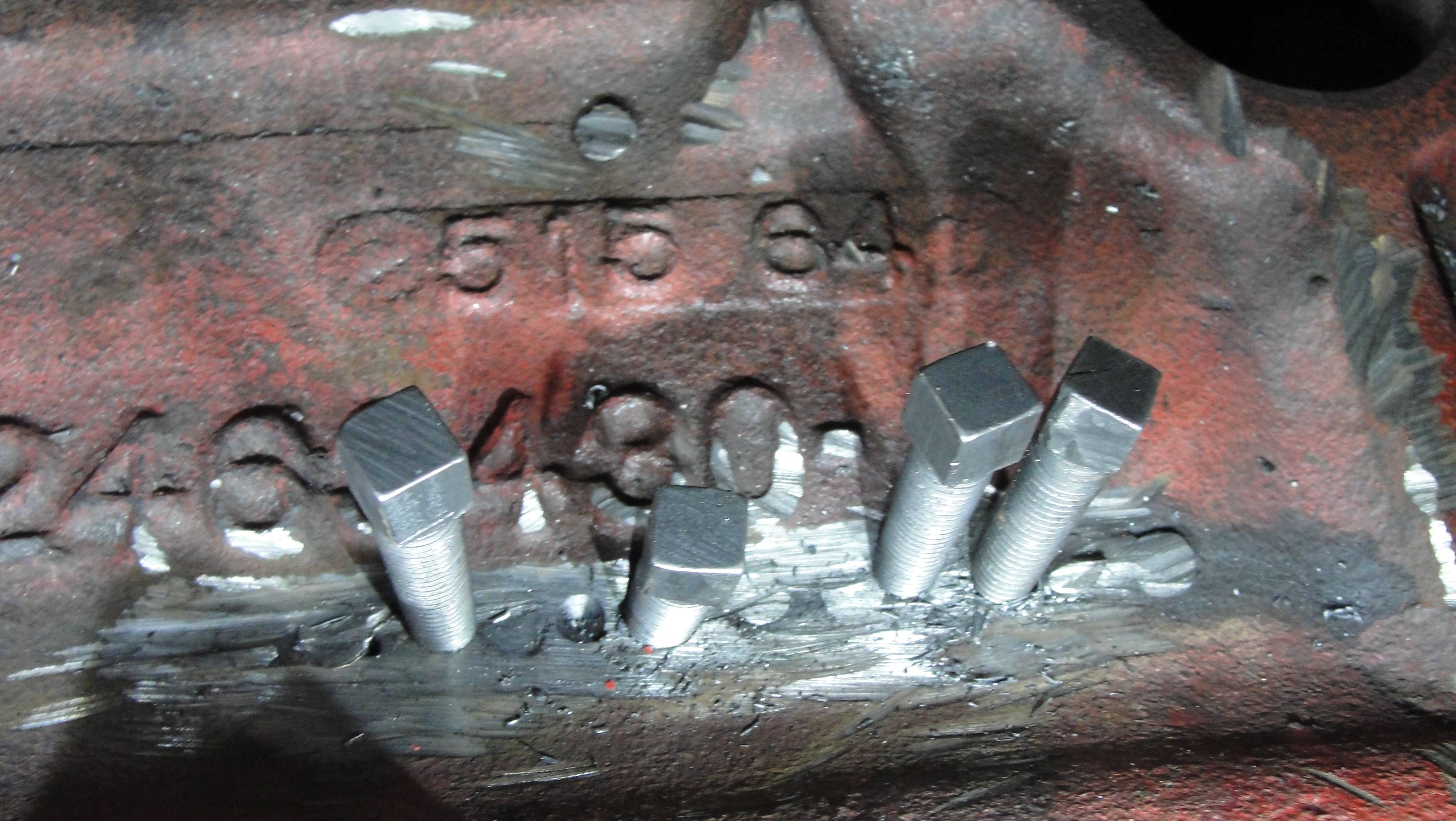

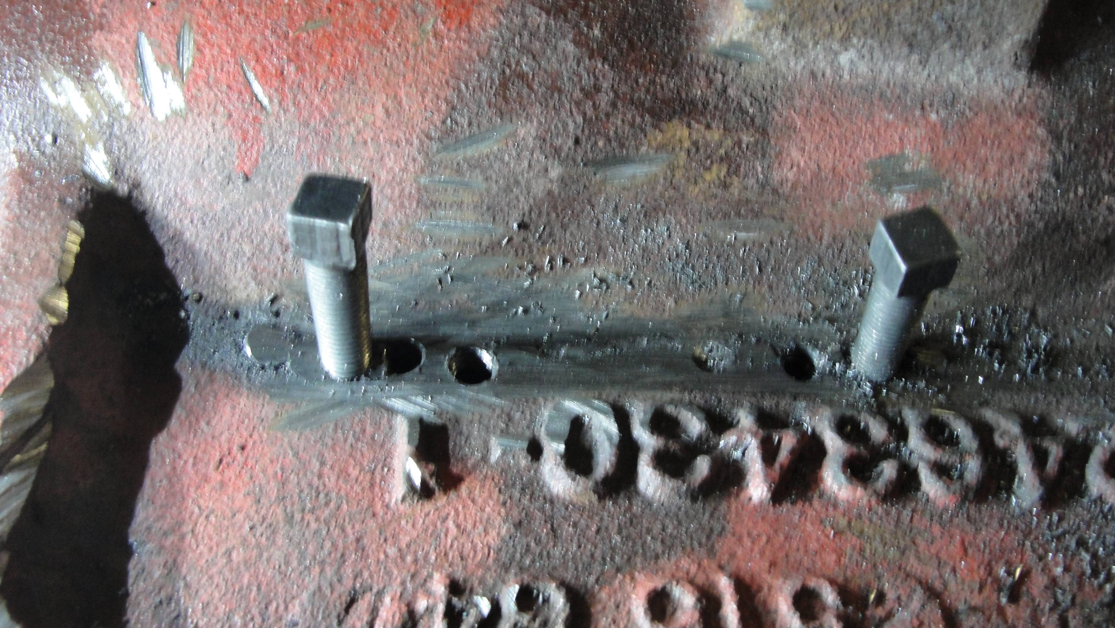

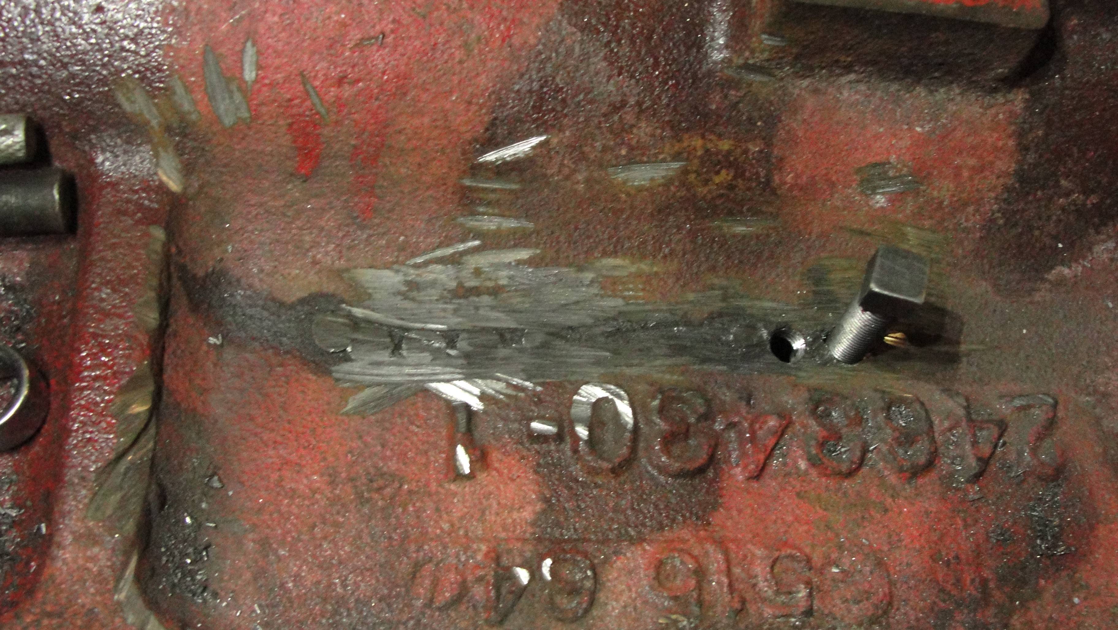

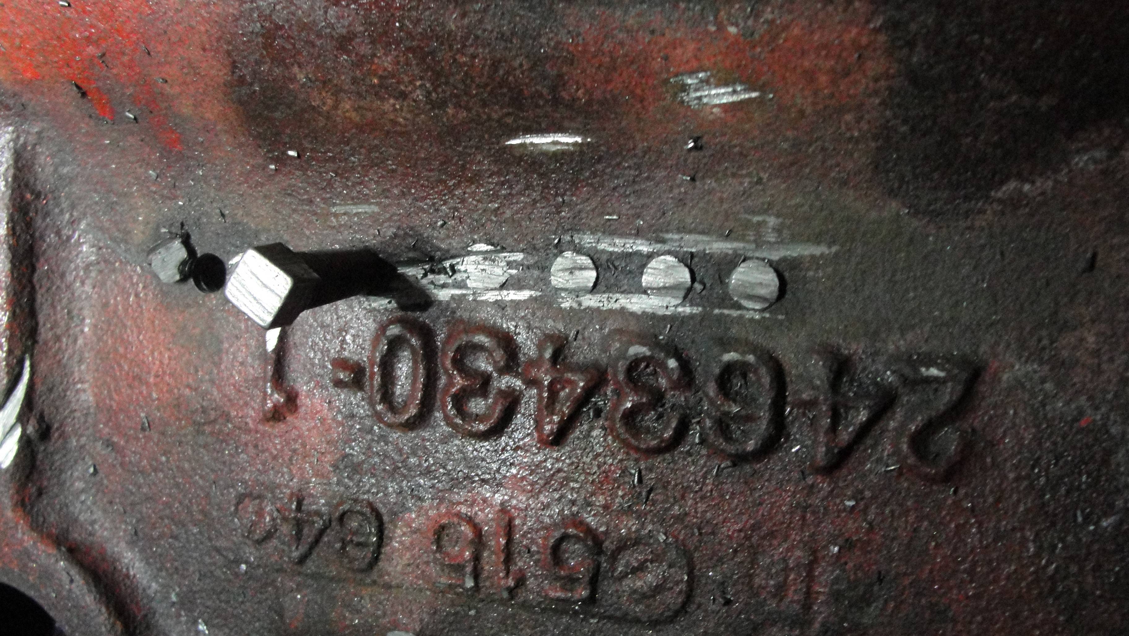

Jan 15, 2020 #1 halifaxhops Retired USAF MSGT (SW) yes navy also. FCBO Gold Member Joined Mar 10, 2017 Messages 3,271 Reaction score 1,967 Location HALIFAX PA Man I wish I knew about stich weld I threw a bunch of big $$$ motors out, easy also just takes a few hours. Drill the ends of the cracks first, drill and taper for the tap, special. put them the first set in and grind flush then drill in between and insert new plugs. Put The next set in so they meet the first plugs. Wow works great

Jan 15, 2020 #3 halifaxhops Retired USAF MSGT (SW) yes navy also. FCBO Gold Member Joined Mar 10, 2017 Messages 3,271 Reaction score 1,967 Location HALIFAX PA I s really surprised how easy it was. Was my fault flushed out the engine and did not drain all the water out! Really wanted the dated block in the car.
