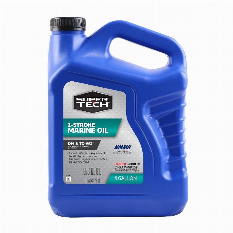

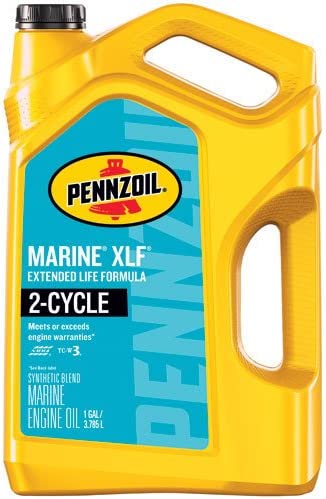

Some of us add this after each fuel refill to aid with lubing the top end. It has an additive that is safe for our older engines. I believe you add 1 oz per 5 gallons of gas. I've had luck with it and @detmatt was the one that told me about it.
you add oil to the gas? Paul
To the fuel. I put in no less than 1 ounce per every 5 gallons of gas at the pump prior to filling. It is mainly necessary if you are running fuel that has any ethanol in it. It will help negate the negative effects of the ethanol. I wouldn’t be able to say that it would benefit sticky valves or lifters.

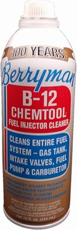

Think of Berrymans as a varnish remover, more than anything else, but more specialized in the varnish which could be the result of oil and fuel mixing, rather than something put on wood furniture. Worked well with the soft varnish which would form from gas fumes out of the carb too, from evaporating fuel vapors.
As 2-stroke fuel oil, it could well be that it is doing some of the same things as MMOil does? Adding a bit of added lubricity to the gas and what it might touch. Whatever works!
Putting gasoline in oil is never good. But putting OIL in gasoline can work well, IF not too much and of the correct type.

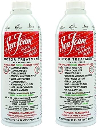

I use mystery oil and seafoam sometimes on our daily drivers. I only put it in if we go on a long drive where we run the whole tank through. I used mystery oil in an old hyundai we had and it did solve some lifter noise!

Project Farm on youtube, he did one video on Seafoam both in the crankcase and gas tank on his Ford Ranger. Results were surprising.
