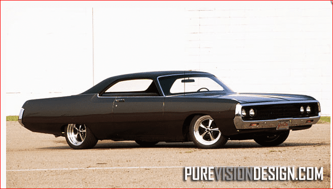

Considering this build - Pure Vision | Big was one of my inspirations I would say definitely use your Newport.

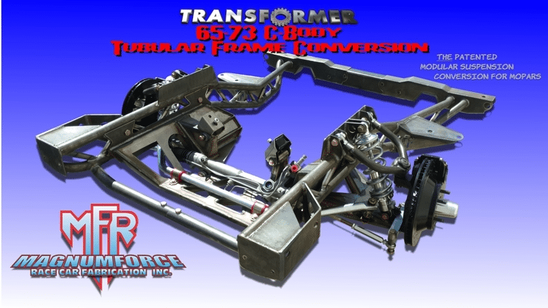

This thing will NOT fit from 65-73 as noted. Might bolt-in for some, but for others will require a bunch of mods. Might not even work at all for the Fusey subframes.
This is the thing that really irks me with vendors.
The "one size fits all" really doesn't apply to C-bodies. It's probably lack of knowledge and experience with the cars... Or a "let's just sell to unexpecting hobbyists" and let them figure out it's not gonna work.
Of course, it goes the other way too.... Parts listings that don't include some of the cars that they will fit.
