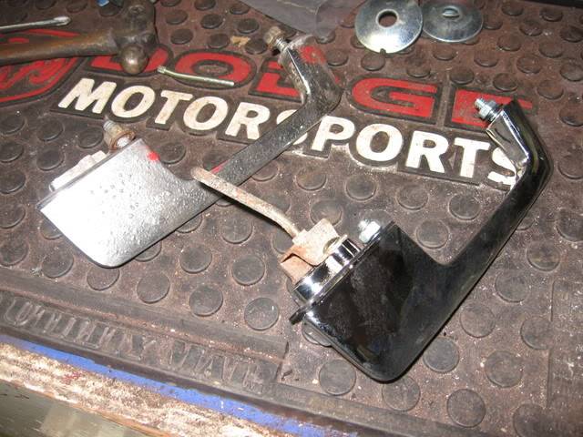

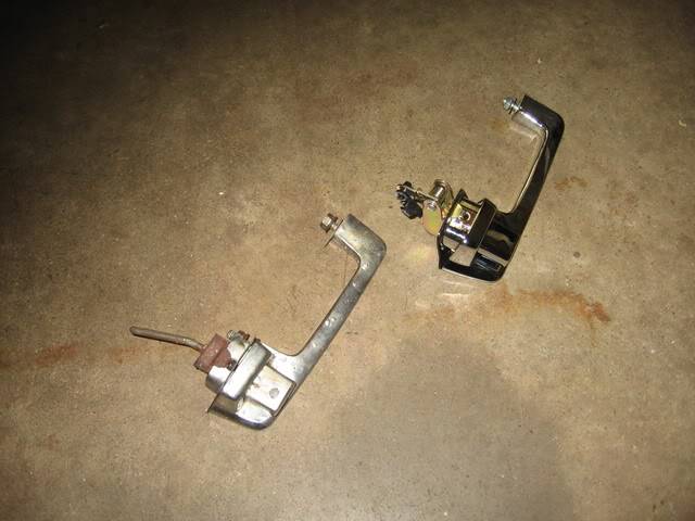

Here is the original crappy,pitted rear door handle and a new offshore repop front door handle.
They are the same ones for A/B bodies and Dodge trucks/vans that Mopar used for years.
The rear door handles simply have a unique rod that directly pushes against the latch.Not unlike the front door ones that uses rods.

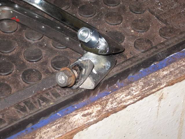

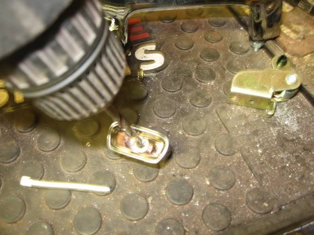

Simply remove the rear door rod by removing the one phillips head screw.
Do the same to the new door handle.

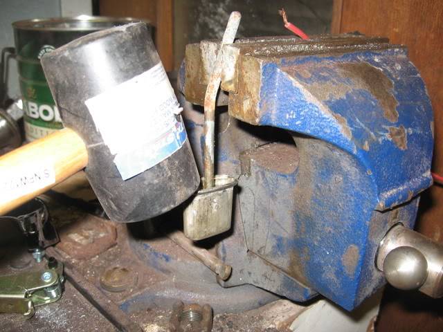

Now the button is next since most old buttons are just as pitted as the rest of the handle.
Two things are needed here.
you need the new button and the old rod to operate the latch.

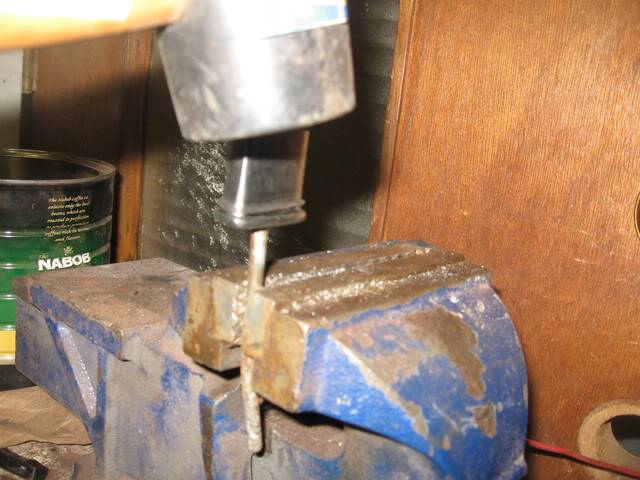

Place the new button in a vise and use a rubber mallet to carefully remove it from the rod.
Also remove the old button so you can re-use the old rod.

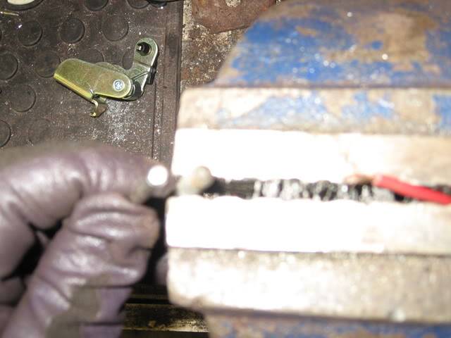

Here is where you need to be creative.
The offshore repops rods are thinner than the original rods.
So,you have to ream the new button just a little to fit over the original rod.
Do not ream it too big or your new handle is now a giant paperweight.

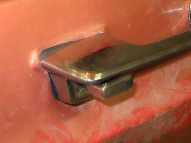

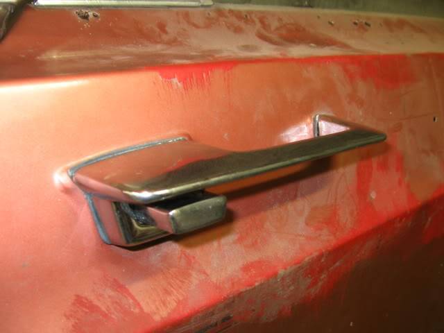

Reinstall the button onto the new handle,and related hardware..
DONE!

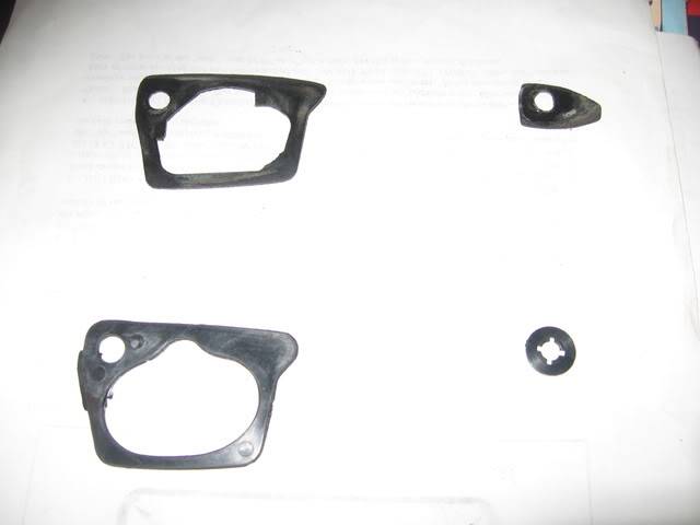

The cheapo repops have metric nuts and threads,and do not interchange with each other.Metric wrenches are needed to install the new handles to the door.
The gaskets are not the best,but they work and nobody will really notice or care and the end of the day.
I,personally,prefer using the original gaskets if they can be reused just for better fit.
Original on top,repop on bottom...
With the handle installed,the repop gasket does not fit all that great.
Here is the original gaskets behind the same handle...much better,IMHO.
Sometimes it is the "small stuff" that makes a car.
Fresh shiny door handles makes a difference when you have fresh paint.
They work well,and look good,so who care where they were made??
