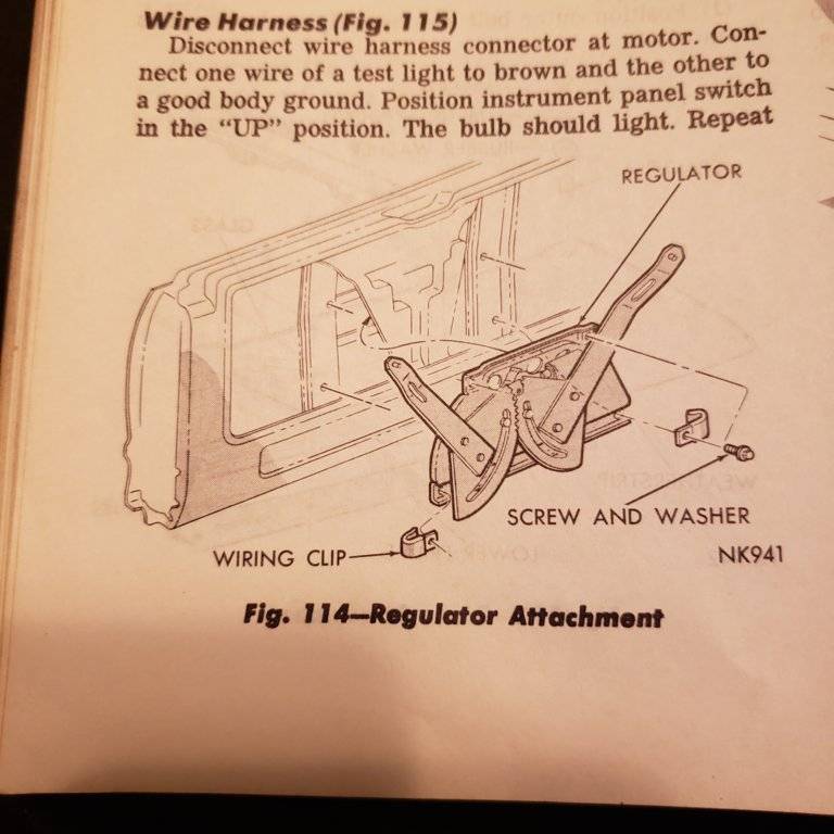

Figure that the whole thing is gummed up and the power motor has a problem. There are two retainers that hold the window regulator to the glass. One removed you my be able to lower the glass which is required to open. Also, the entire regulator and motor assembly is only held to the tailgate with hour bolts, so that may also ease access. Ill sent a shop manual photo in a moment.

The plant put the regulator and motor in as an assembly, and that is how it comes out, and how you service the motor. Whatever you do, DO NOT remove the motor from the regulator without a vise grip or clamp securely holding the regulator arms in place. Trust me.
Once all of the window stuff is out of the way, a thorough lubricating spray on the latch and handle mechanisms should get the door to respond.

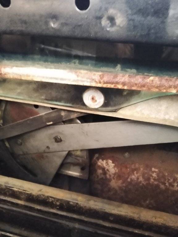

Awesome thank you, how do you remove the rollers from the track on the window without rolling it down? Looks like just a internal star washer you pry off?
There's no way to get at those washers without the window coming down
I've applied power again, and tapped on the motor, no go
I pryed they tab up to get at the motor gear. Tried to spin it, no luck
Looks like I have to drop the regulator down to get at the washers, wish me luck...

Success!! After pounding in the motor about another 10 minutes, and tapping the down switch at the same time, I got it to go halfway down!!
These seem like they are screws not starwashers..
