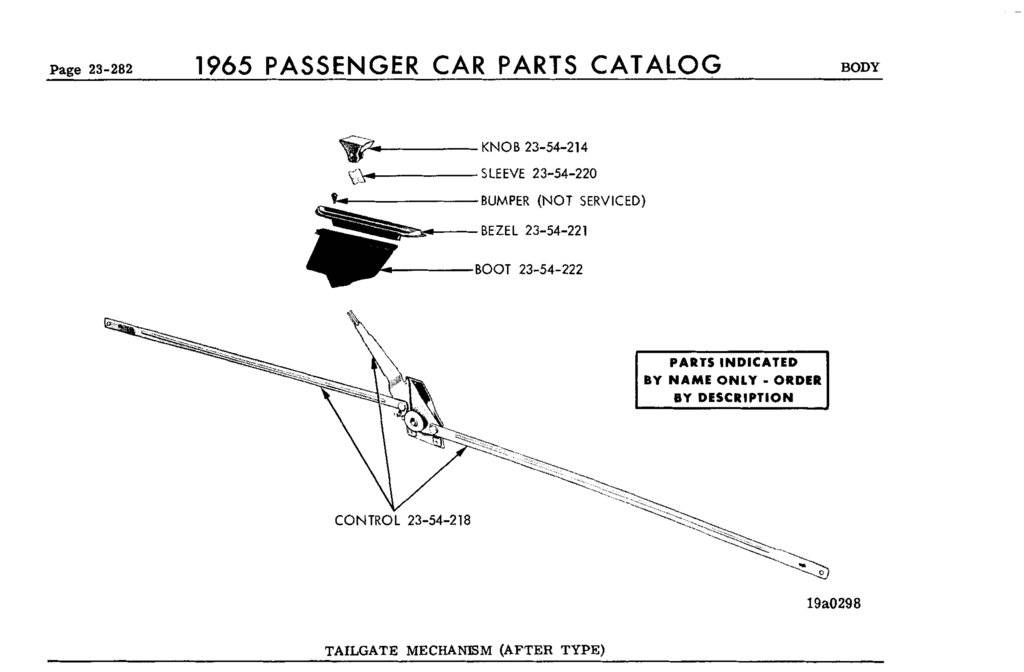

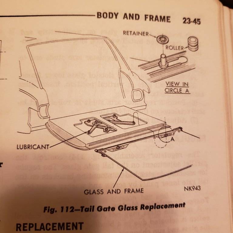

Here are pics from the parts catalogue, showing the breakdown of the tailgate, and more importantly, the latch mechanism and how it works.

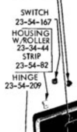

23-54-167 is a switch, looks like it's maybe around the latch, you know what that is?
I provided two diagrams - which one?
Also, there is no switch or electrical interlock with the latch mechanism of any sort. The interlock only prevents the tailgate glass from being raised when the tailgate is open.
If the glass is down and the latch mechanism operational, the tailgate should open.
Page 23-281 the bigger parts diagram, just curious what that switch is
Mopar 440 can you see/find the switch yourself or is it hard to see/find? I would say trace the wiring from it to wherever it is going...?
