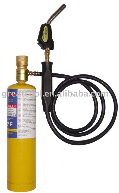

Pick up something like this, Mapp gas cylinder and hose assembly for heating things....works great!
