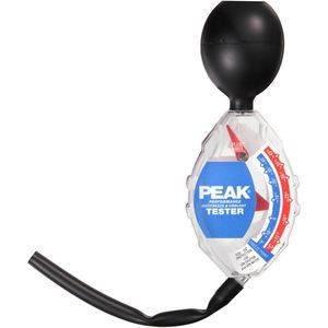

I did put a full tank, my dad told me that one. How do I know if the antifreeze is good.
These are no more than $5.00 at any Auto store...
