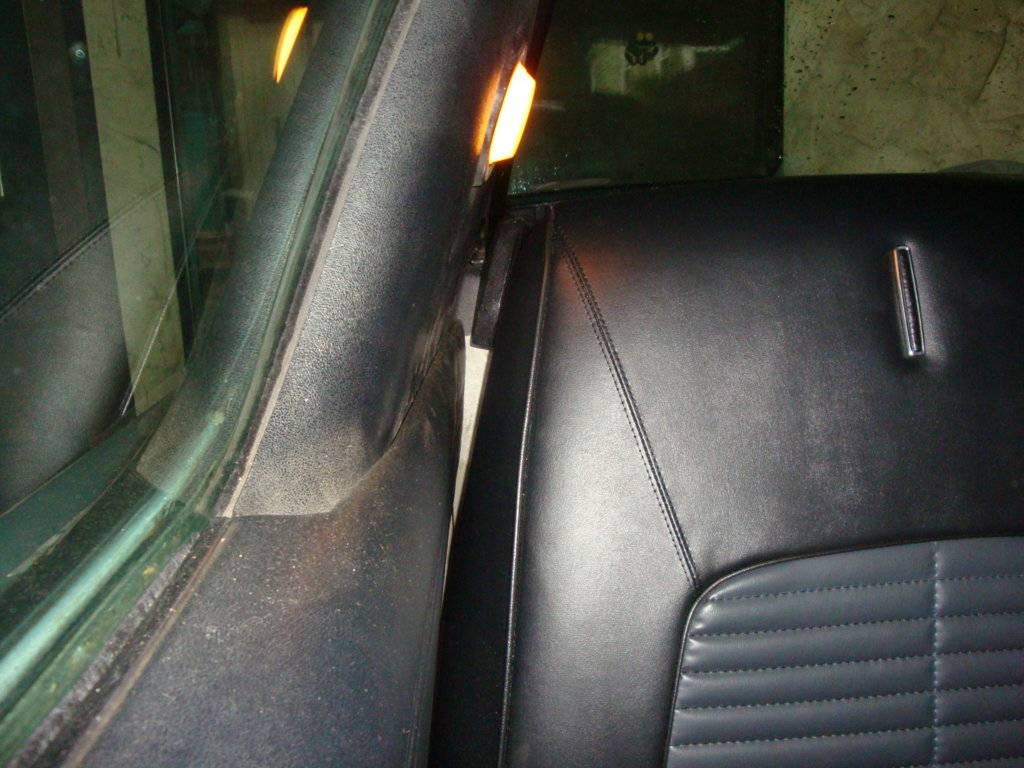

Was just looking at the post about converting mikes 66 rear seat. much bigger job then my 68 300. I did see something I my be missing. Did the 68 also use a filler on each side of the seat back 0n the 68. It looks like I my be missing a filler. My seat back fits from side to side but near the top I can see a small space.
No side fillers in 68. please post a photo of the gap issue

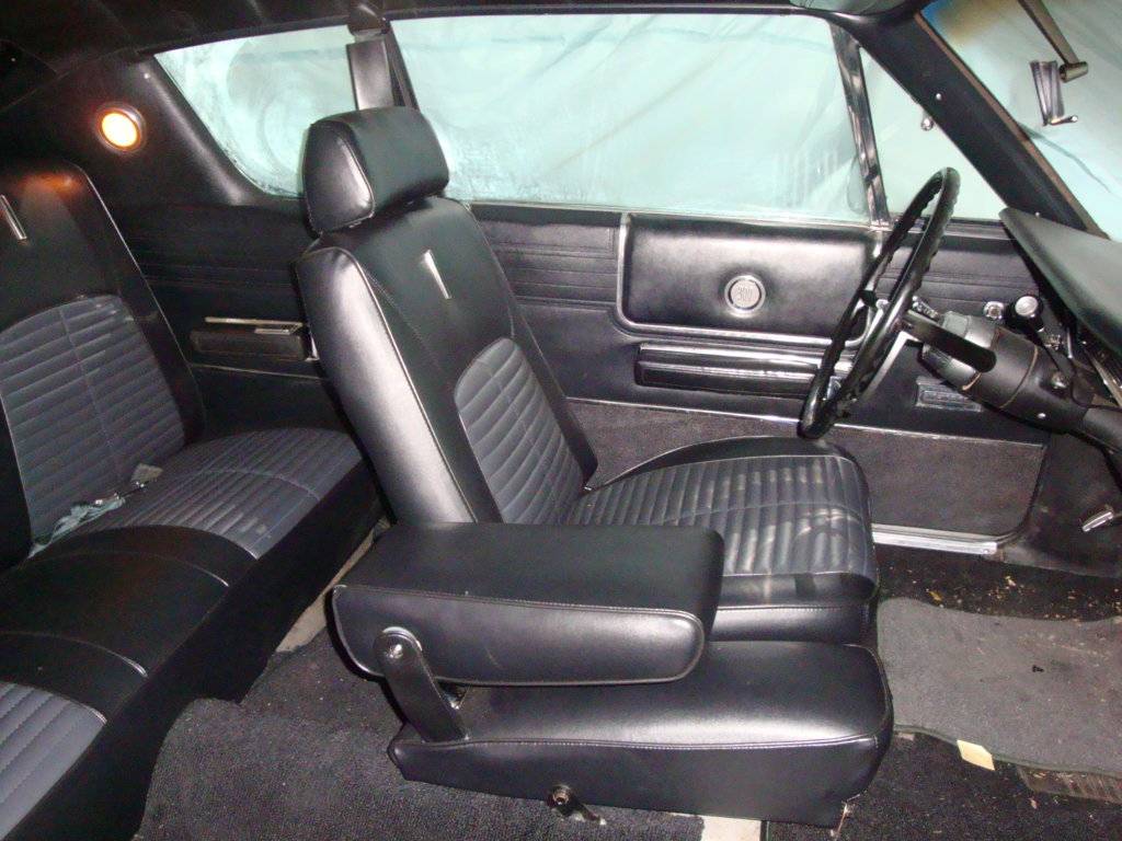

This is the black and grey that Legendary recommended. I think all black is correct but I went with b/g. what do you think. Its ok if you do not like it.
The b/g looks fantastic!
The factory colors were two tones anyway -with a marble effect coordinating insert.
I think your choice looks classy and a big improvement over all black!
Was thinking about using the grey and replacing the padded part of the door panel above the arm rest. I bought an extra yard of grey to do this.
