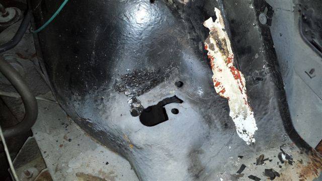

Hello fellow Mopar restoration enthusiasts!
I am just getting starting on a sub frame swap out as well as restoring the under the hood area back to the original white.
The PO had used POR15 and thankfully not the correct way as it wants to peel & chip off the paint that is underneath the POR15.
I am sure though that I will run into areas that are properly coated.
I wanted to know if there is anyone having to have removed POR15 in the past.
I am curious as to how you would go about it.
Will a stripper work or do I need to grind or bead blast it down?:buffer:

To my knowledge chemical strippers will not work. You have to use some sort of abrasive material to remove it...sand blasting, or grinding disc, wire wheels etc.

POR15 works really well when applied over rusty metal. It needs some "tooth" on the surface to grab on and then it's really hard to get off. It doesn't stick well to painted surfaces, especially those that may have any oil on them... Like under the hood.
Sandblast is your best bet. If you want to do it right, you'll want to sandblast the surfaces to bare metal anyway. You can probably grind through it. I would suggest you wear a respirator if you grind it off. The top surface of the paint is very hard, so sanding it will be tough.

Not exactly the best product, but I discovered gasoline will wrinkle the POR 15 right up and it will wipe right off.
