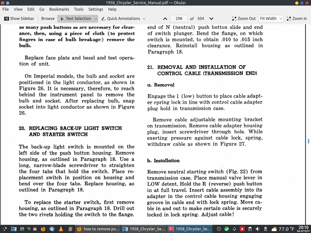

Jun 12, 2021 #2 70NEWYORKER Well-Known Member Joined Jul 6, 2017 Messages 809 Reaction score 1,163 Location Northern Illinois Maybe these will help.....
Jun 13, 2021 #3 mikedrini Well-Known Member Joined Oct 9, 2017 Messages 701 Reaction score 663 Location Center Barnstead, NH Sooo much easier with pan off so you can see exactly what you're looking at.
Jun 13, 2021 #4 4 413 Senior Member Joined Jan 28, 2019 Messages 1,856 Reaction score 2,160 Location NW USA And once you know how it’s done it is really easy with the pan still on. But the spring clip can be on upside down so you don’t know which way it points so try top and bottom. Last edited: Jun 19, 2021
