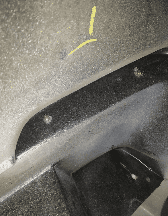

Here's how the pads are affixed to the panels on my 68 300 vert
Now that I think about it, I could probably just use my Dremel and a disc and carefully cut away the plastic fingers that are protruding around the bolt and then push them out. Then just use regular nuts to reattach them. Thoughts?

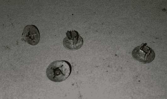

So I got the armrests removed from the side panels yesterday. These are what were holding them on:
They weren't threaded and were pretty easy to just break the tabs off them with a dremel tool to cut and small screwdriver for prying.
