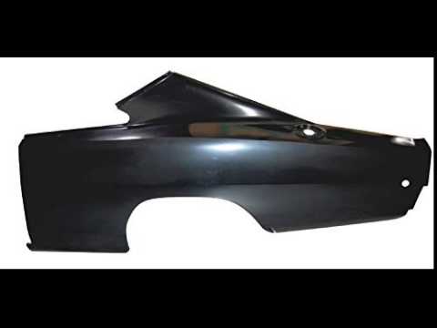

  8. Mr C
    Mr C Senior Member
    Messages:
    3,506
    Likes Received:
    1540
    Joined:
    Nov 20, 2012
    Location:
    All over
    Here's a pic of what a total quarter panel replacement looks like (Not a Chrysler panel, because...of course...nobody makes those!).
    As mentioned there will be a lead seam on the C pillar that needs to be cleaned out to access the spot welds. These are spot welded all the way around the perimeter.
    Process: Find all spot welds- drill out. You'll likely need to air chisel around the perimeter to loosen the panel. Then clean and replace using the reverse of the process...being sure the panel is well aligned.
    • Like Like x 1
    • Thanks! Thanks! x 1
    • Agree Agree x 1

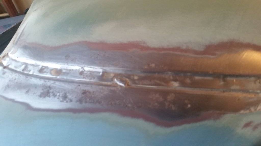

    Here's what that seam looks like...

    Mine was original and was a white filler type material I could pry/chip out with a screwdriver blade.

    I believe non vinyl top cars were leaded and finished better while vinyl top cars had a soft plastic type filler. I've also seen them with a little lead in the corners with no filler along the rest of the seam. Typical Mopar, never say never.

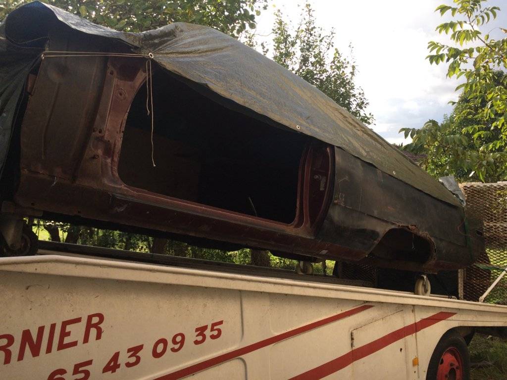

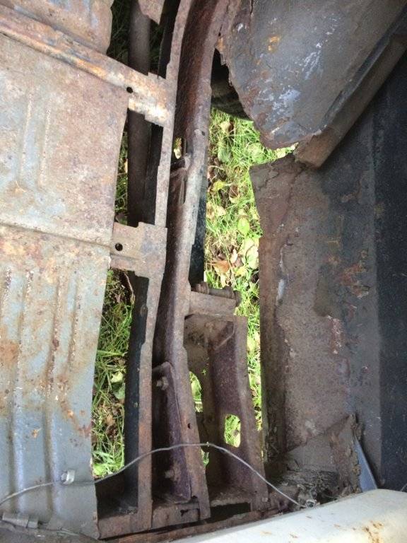

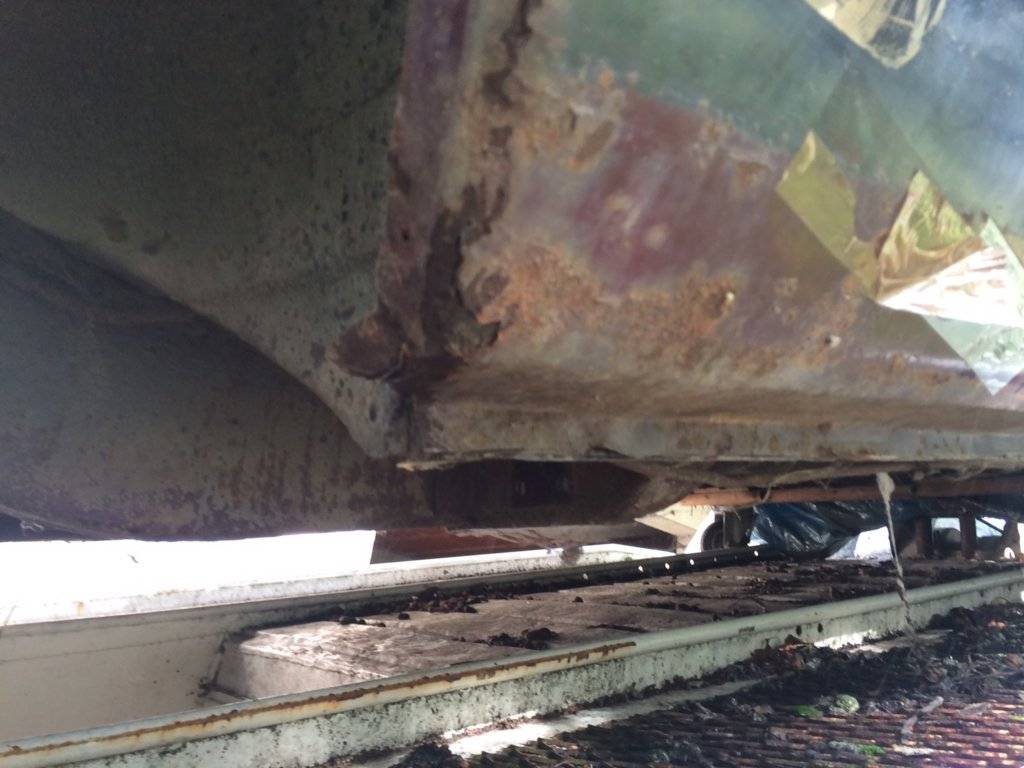

  17. Xavi3r
    Xavi3r Active Member
    Messages:
    343
    Likes Received:
    126
    Joined:
    May 24, 2014
    Location:
    France

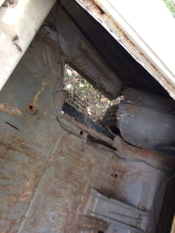

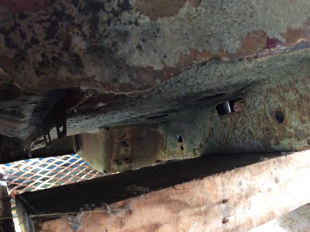

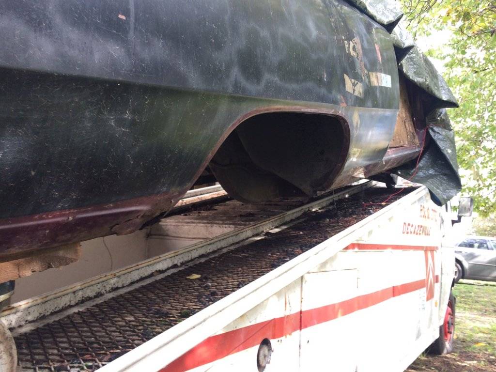

    goal is to repair this
  18. detmatt
    detmatt Old Man with a Hat FCBO Gold Member
    Messages:
    23,909
    Likes Received:
    9972
    Joined:
    Nov 14, 2010
    I’d cut out the pieces you intend to patch prior to media blasting but the quarter has to stay on in this case.
    • Agree Agree x 3
    • Like Like x 1
  19. Davea Lux
    Davea Lux Old Man with a Hat FCBO Gold Member
    Messages:
    5,546
    Likes Received:
    1451
    Joined:
    Mar 27, 2017
    Location:
    Cornelius Or
    You would want to do as Detmatt said. Find the lower quarter sections from a donor car and splice them in, the upper part of your rear quarter is not that bad. You can wire weld using low amps and small wire in short passes so as not to warp the panel. Rust free metal for these cars is hard to find, so you may have to do some fabrication and make your splice parts.
    Dave
    • Agree Agree x 2
    • Like Like x 1

    Find a new guy to blast the car. I understand what hes thinking...I THINK...but this isnt a Cuda or Charger and you cant just call up AMD and order replacement panels.
    Ideally yes, it'd be nice to blast all the hard to get areas and coat them properly, but at this point in time, the after market isn't there to support tearing the C bodies down to the inner skeleton.
    Dont remove that quarter.
