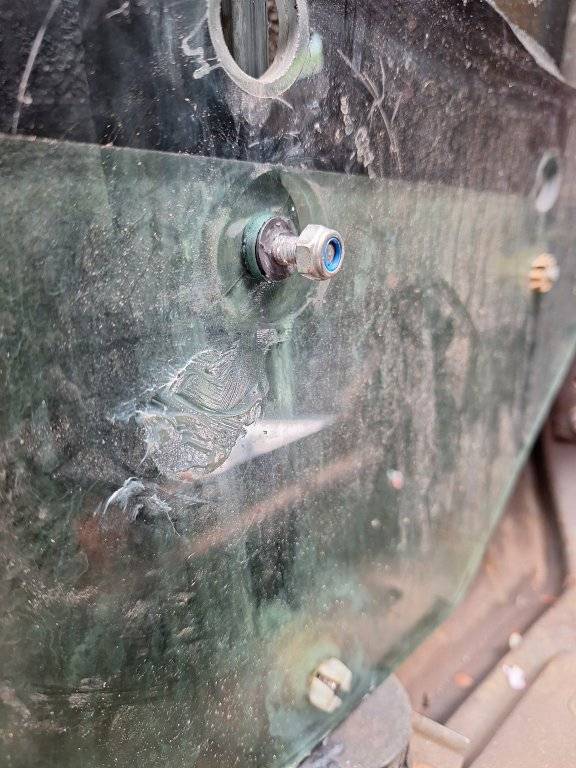

like the title says, how to remove the wheatherstrip on the door? I'm in the progress of pulling out the left door glass including front track.
That seems impossible with the wheatherstrip still in place. The manual says to remove it. But how?

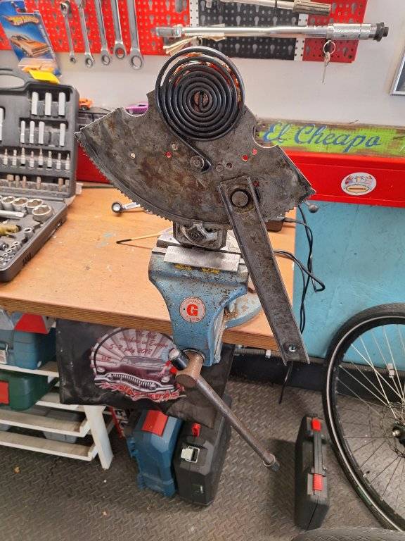

I'm doing this because the (manual) window has been very hard to raise ever since I bought the car.

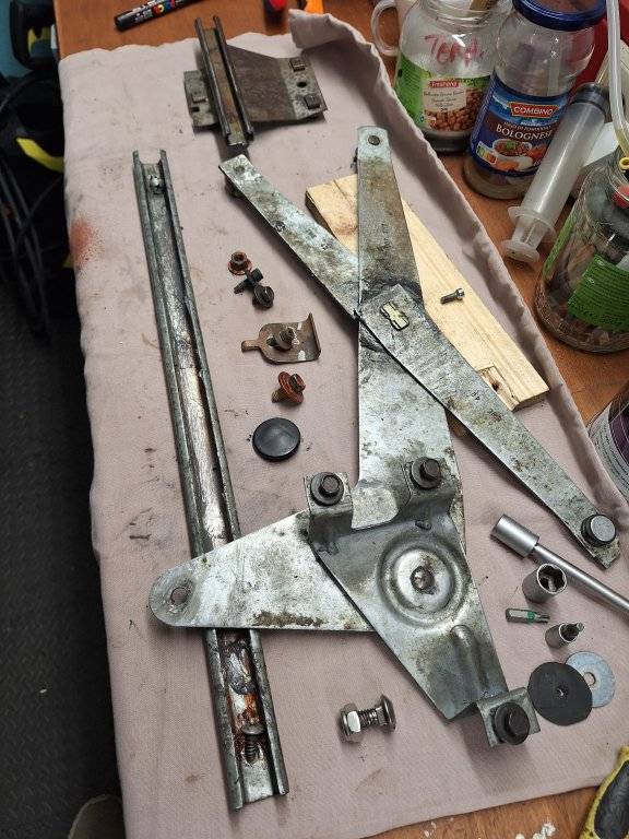

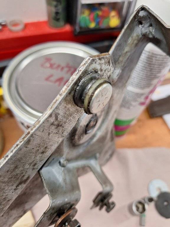

With the rest of the assembly out of the door, I'm convinced the problem is a non original rivit/sliding block in the front track.
There still is some resistance.
On the subject, where to find rivits and sliding blocks for C bodies? Are they different from B bodies?
This roller in the regulator arm doesn't look stock either, like the original slider block.
Another friction point?

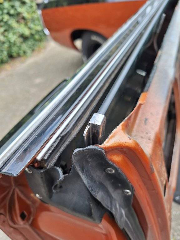

Ok, checked right away, both doors. No screws to be found, so it must be clips. But with the glass still in the door, up or down, there is no way to touch the backside of the lip. You just cannot reach up there..

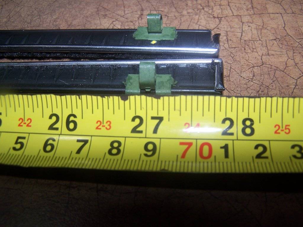

Those weather strips are commonly called "cat whiskers".
They normally have clips every 4-6". You can try sliding a putty knife or slim tool between the metal strip and door and pry them away from the door. My experience with them has not been great since they break or pull out of the strip instead of the door. You may be finding new replacements if that happens. Maybe you will get lucky. Here is a pic of what the clips look like. Also, you may have to drop your window down stop a bit to get the glass down and out of the way. Good Luck.

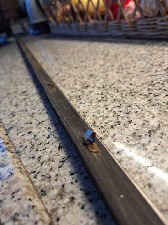

Well you were right, clips. 12 of them, Only 2 survived... Carefull or not, they are thin and brittle. They are positioned a bit different than the green ones you posted. Mine are in the middle of the strip. Hopefully I can find new ones. Along with the other glass roller parts.
Your luck looks to be like mine. I have not tried any of these but you may want to look into finding new cat whiskers here for you Chrysler. Not sure how many are out there for C bodies.
