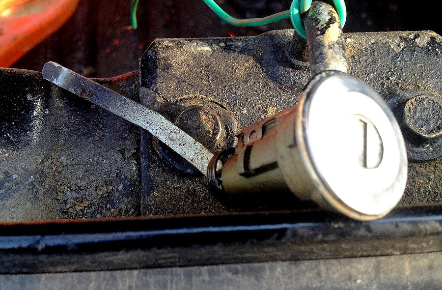

I'm a young beginner in Mopar world, I've bought last week a 1968 Chrysler 300, I have a lot of work on it and I'm gonna do a more complete presenting thread soon (I'm on my mobile now) but I would ask you this answer as soon as possible: how to remove the trunk lock cylinder? My lock does'nt works so I've opened the trunk by inside (just unscrewed the two bolts on the ketch) but now I must remove the lock to repair it or bring it to the locksmith and it seems really strangely made...

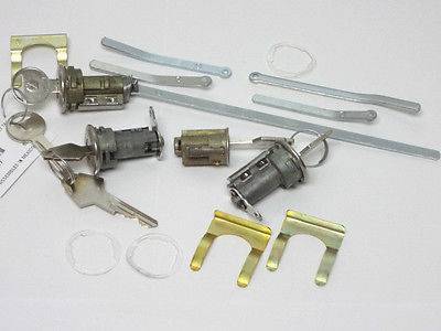

There is a U shaped clip on the inside of your trunklid, like you see on the lower right of the picture. You have to pull that off sideways with a screw driver or a pair of pliers and the lock should slide right out.
Nice thank you guys for that quick answer! :p
I see the clip, but when I try to slide it down it "bumps" on the edge of trunk door, there is a "trapdoor" that seems to be there to let getting out the clip but this "trapdoor" seems to be welded and riveted (is it a word in english? lol)
Maybe if I turn the clip on itself and slide it sideways it can works?

You can pull the clip off in any direction. Try to twist it into a good deirection with a screw driver. That worked for me. And soaking it with penetrating oil will help also!
I got it! :D
I try to turn the key into the lock but it really does'nt works so I bring it to the locksmith tomorrow morning, I hope they gonna be able to do something
