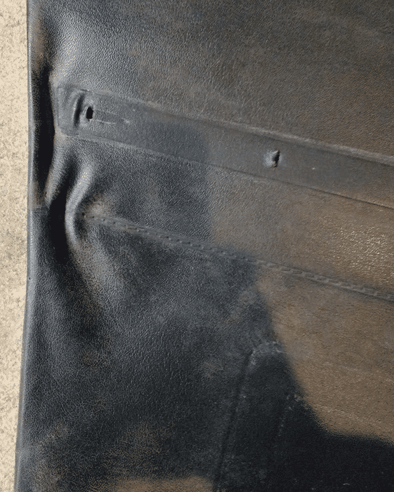

I made a new door panel backer for my 68 New Yorker and I'd like to to put the original vinyl onto it. It has no cracks or tears but there wrinkles on each end of it. I have to be careful with it because it it does not feel super soft and pliable. It feel like too much manipulation will cause it to crack so I don't want to just try and stretch it. I'm thinking of gently heating it and using something flat and heavy to work out the wrinkles. But would love to hear if there's a more tried-and-true method than that.

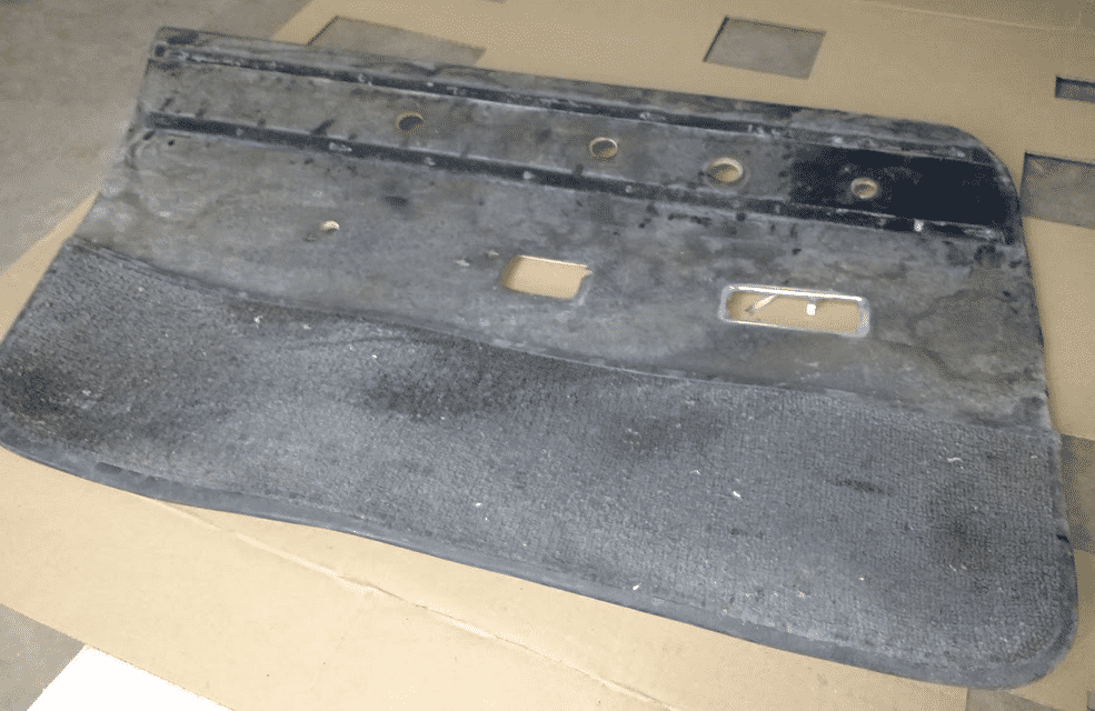

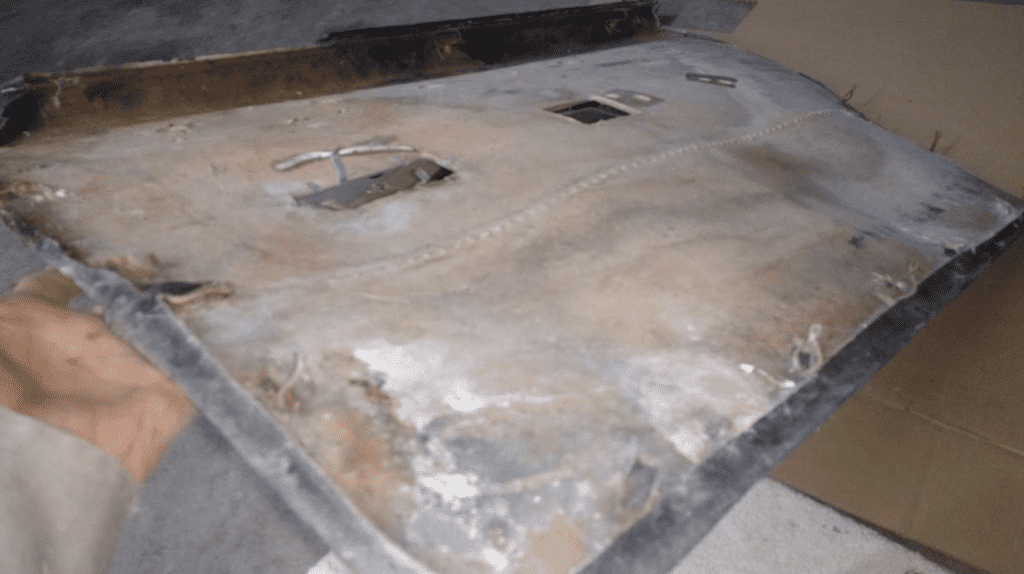

I wasn't clear in my original post, but the vinyl as you see it in the pictures has already been removed from the backing, so those wrinkles are it's natural form now. The backing was shot to heck from years of sitting in a damp environment. Here are some "before" photos:
One issue can be that the original material has somewhat dried-out (the base oils in it) as it aged. This is normal. Gentle heat over a period of time, with possibly some good vinyl conditioner (NOT an ArmorAll-style lilquid!) could help restore some of the original pliability to the vinyl. This will take some time, so multiple gentle heat/conditioner applications might be needed. Of course, benign gentle in handling the vinyl is necessary, at all times.

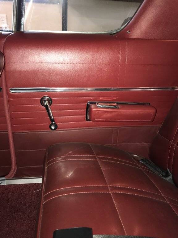

Leather would have been only on the seating surfaces, NOT on the door panels. The vinyl would be grained to match the hides on the seating surfaces, typically.

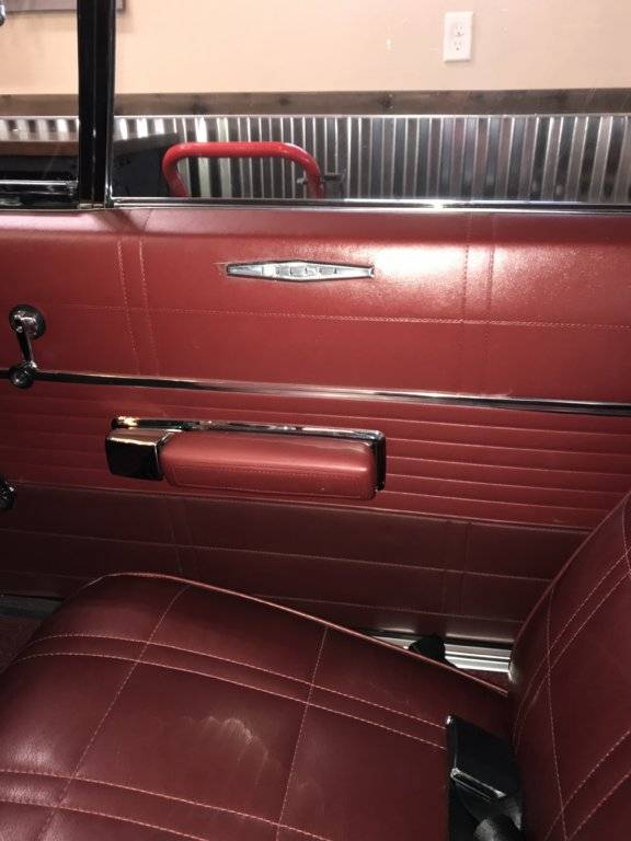

Finished product.
