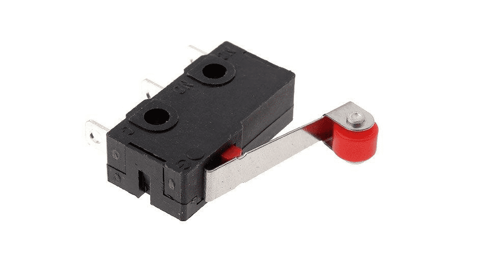

As said, the rooster comb/nss isn't your problem. But since you ask, its simple to change. Drop the pan, drop the valve body. E clip holding the comb on. Change the seal on the throttle valve of the valve body and the seal on the shifter on the case while you are there.
But, instead, just find some sort of limit switch that hits the linkage in reverse and call it a day.

Am SOO glad to know there was nothing involved requiring any crap with the NSS/ That little switch might work. I see some old stuff on this Saginaw non-tilt column that appears to have once been connected to SOMETHING, and its wired in the same 18 gauge purple wire, with a similar connector. Looks incomplete though. There may be something lacking on this column. The artifact I found is down low, near the firewall.....
