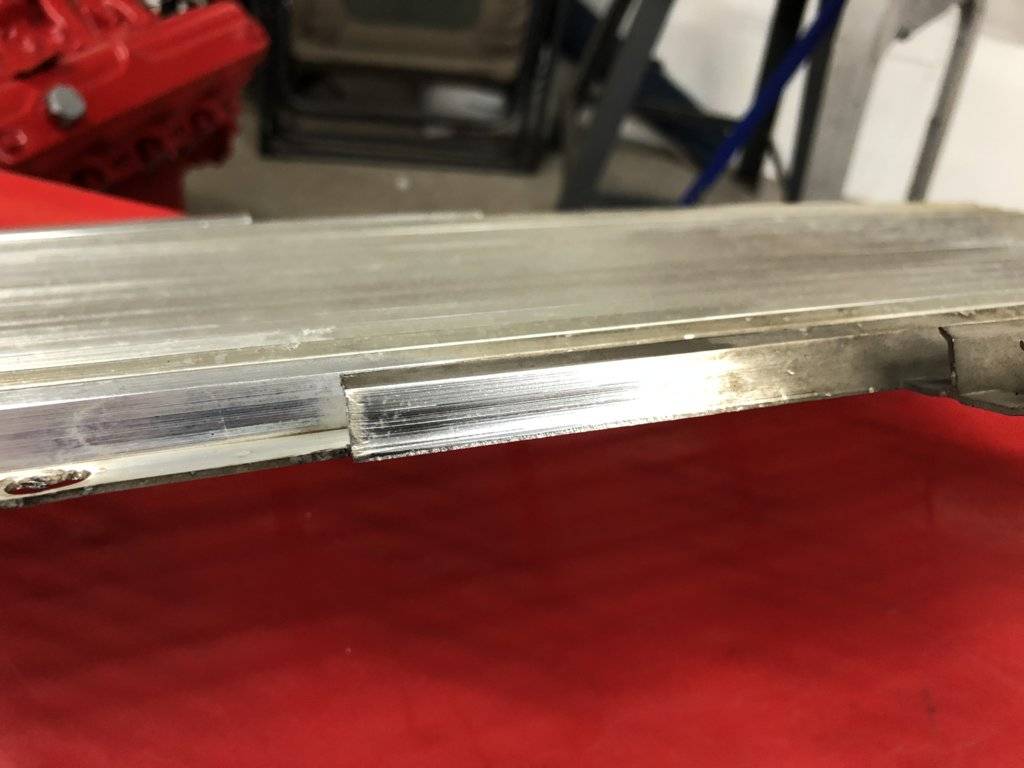

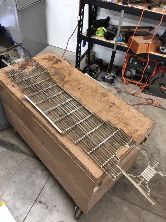

60 Fury grill. Dirty. Dull. Can’t get fingers in those deep recesses. There must be an easy chemical or abrasive solution that doesn’t require elbow grease and torn up fingers...

QUESTION . . . Is that grille chromed steel or anodized aluminum? THAT will determine what cleaner to use.
My suspicion is that it's anodized aluminum, clear anodize. To do a chromed steel item like that would have been very expensive to do, especially with all of the hand-work needed to get it polished out.
Now, if you use a cleaner on the anodized surface, with a too-fast drill motor speed, that'll "burn" the anodize and if you continue past that, burn through any anodize that might be there, which means you'll have to do the whole thing that way. In another thread, there was mention of an easier way to get the anodize off.
Another reason for it to be clear anodize aluminum is that the anodized surface can be less picky about water spots and such, than chrome would be. I'd hate to think of wiping down that whole grille every time the car was washed, rather than a quick dry or "blow dry". Everybody has their own tolerance level of such, though.

It is definitely anodized aluminum. I have been down all those roads. My 77 T&C had it all de anodized and polished like chrome and, yes, will need regular maintenance.
I was hoping to find a miracle cure to separate the dirt and grime film from the anodized surface and then just polish the anodizing. Oven cleaner will get the anodizing off in short order then leave a nightmare polishing job on all those rungs - at least to get them chrome-like.
I’m going to try all the solutions here and see which works ‘fastest’. I already tried an anodized aluminum polish from Eastwood that is made in Germany. It made one spot look like new, but then it is not touching other spots. It is a near miracle cure and tells me something will dissolve just the crud.

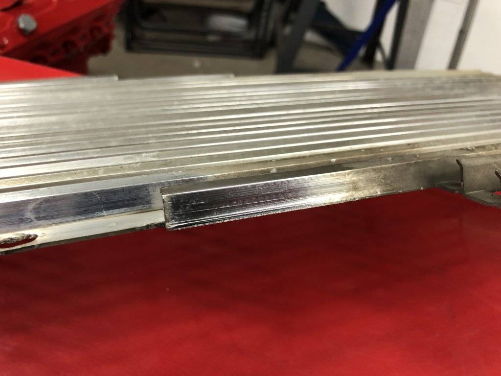

FOUND THE MIRACLE CURE. Took a chance on a product at a tent at the Daytona Turkey Run. $10 and they said if it worked I could get more at Walmart of all places.
Rubbed it on till it turned black, very quick and little pressure. Let it sit a few seconds (they said a few minutes) and voila, everything wiped off clear as a bell.
Exactly as I wanted. Couldn’t have ordered a better product.
Same EXACT process you describe but with "Brasso" that I described earlier and it about half the cost. Remember what I said about reinventing products.
