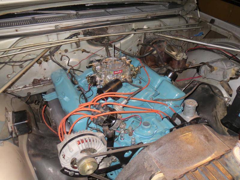

I detailed my 69 300 under hood without removing the engine, It came out ok but was a lot of extra work.

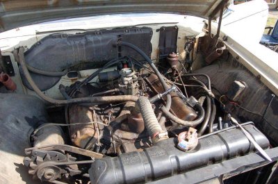

Lets be honest, you are going to clean up that bay while the engine is torn down, correct? So do it right...
Before..........................

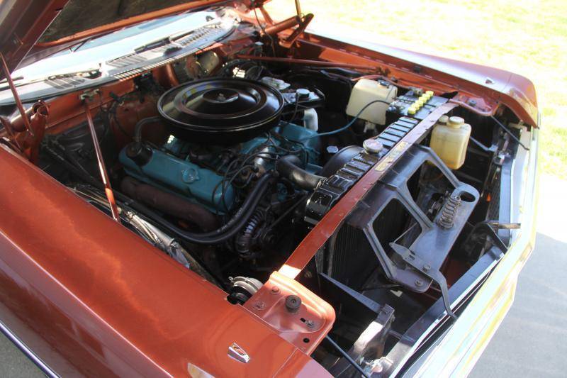

and after.......................
Engine is rebuilt and painted and the radiator is re cored and painted thats it... you'll be sorry any other way
