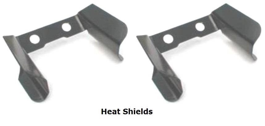

69 Chrysler 300, swapping from log exhaust manifolds to HP exhaust manifolds. 2863409/2806900
Are the spark plug heat shields with the log type manifolds retained? Are there different heat shields used or are there no heat shields used?
Thx
There are some different styles used over the years, the 69 with the HP manifolds use the ones like these (picture found on the web)

I have HP's and never used heat shields and never had a problem but you may want them for originality which would be cool. Anyone making robops? Like to see a pic of a set on an engine.
if they are still on your car you can reuse them if in good shape. Same for HP and std manifolds.

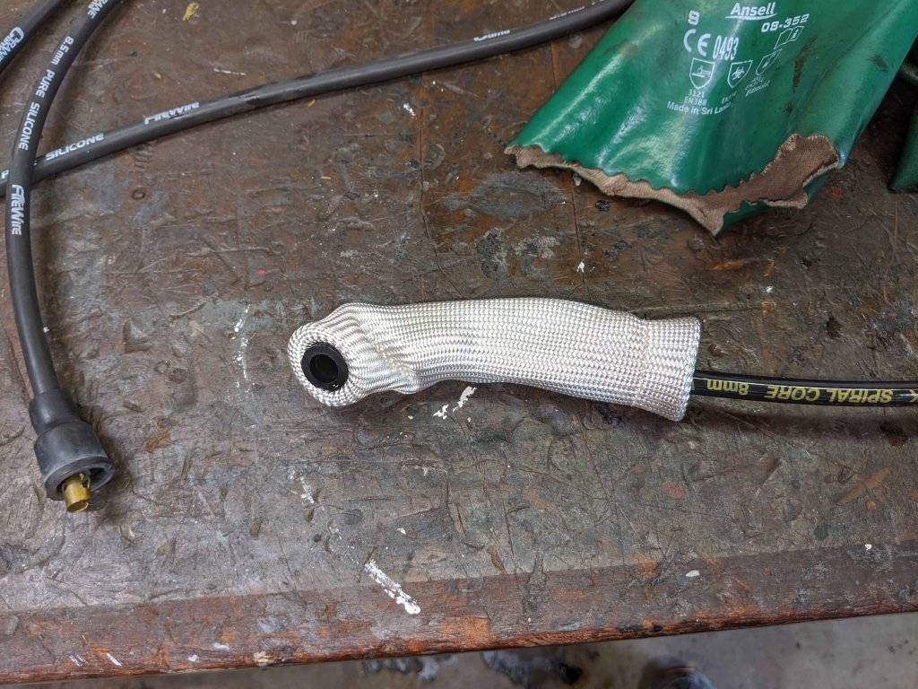

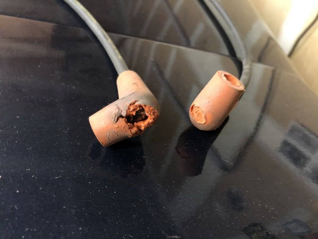

First Picture:
I wasn't so lucky
Second Picture:
Here is a picture with one in place, can get a better picture later.

MrMoparCHP.... just to clarify...did your wires burn without the shields or with them?....since pic 2 shows you've got them
Before, new wires were put on the car in November 2020 when I got the car, taken off September 2021 when I pulled the engine for detailling.

ok thanks...i know 70FuryConv melted a couple during break-in and he was using the early shields...i decided to use the larger ones figuring there had to be a reason the factory made them bigger...but i'm far from firing it up...looks like i have the same date code wires with the orange boots as you do
Ok you convinced me ,I bought a set for the 69.
