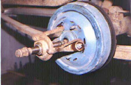

I have three (3) BRAND NEW ++ N.O.S. ++ 1963 - 1964 CHRYSLER 11" x 3" REAR HUB & DRUM ASSEMBLIES!!!!!
Is this what you are looking for? The '63 - '64 is the "old Keyway" design -- starting in 1965 they were just bolt on

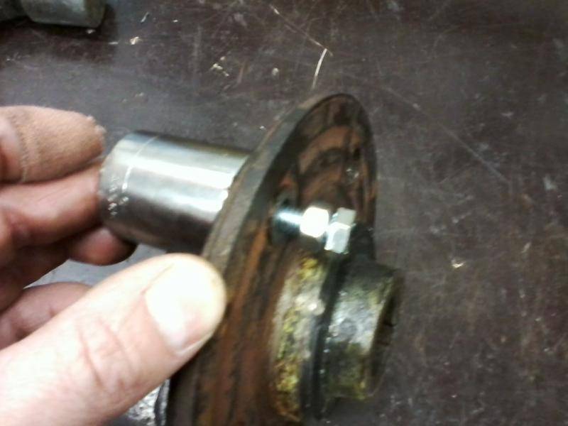

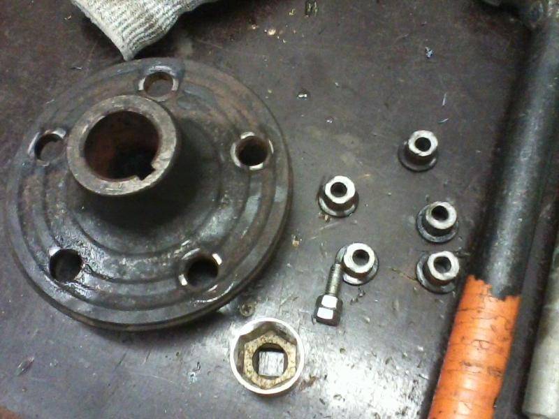

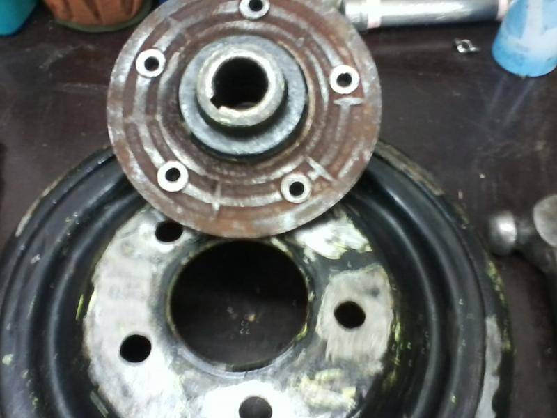

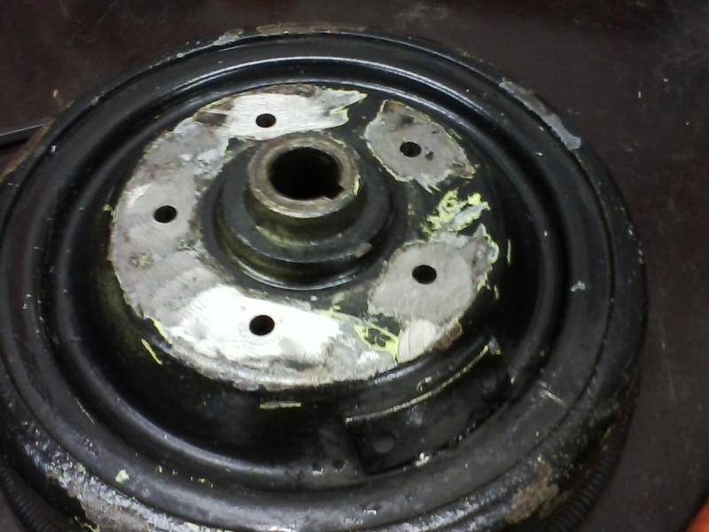

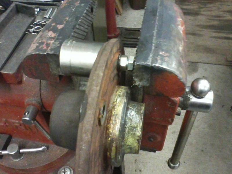

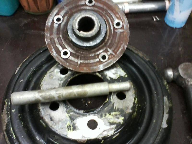

Got the drum off and will try pressing the hub out this coming weekend. Im on vacation over Christmas so I hope to pull the rear end out. I am trying to pick up a 741 chunk with 323 suregrip from a guy in the area, he wants 375, Iam hoping to get him down alittle lower. We shall see how it goes.

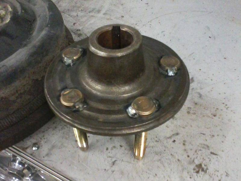

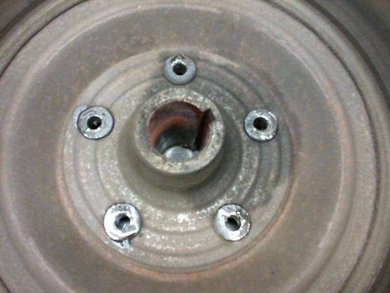

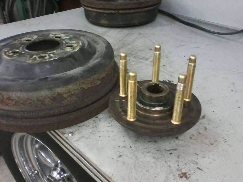

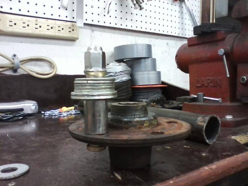

Well, today I separated my drum from my hub and pressed in new studs, everything went way too smooth. I managed to save the drum but the studs that people recommended from the internet were a touch too small. I order .625 because factory was .622, next time I will go a little bigger. I ended up spot welding the back of the studs just to be on the safe side.
