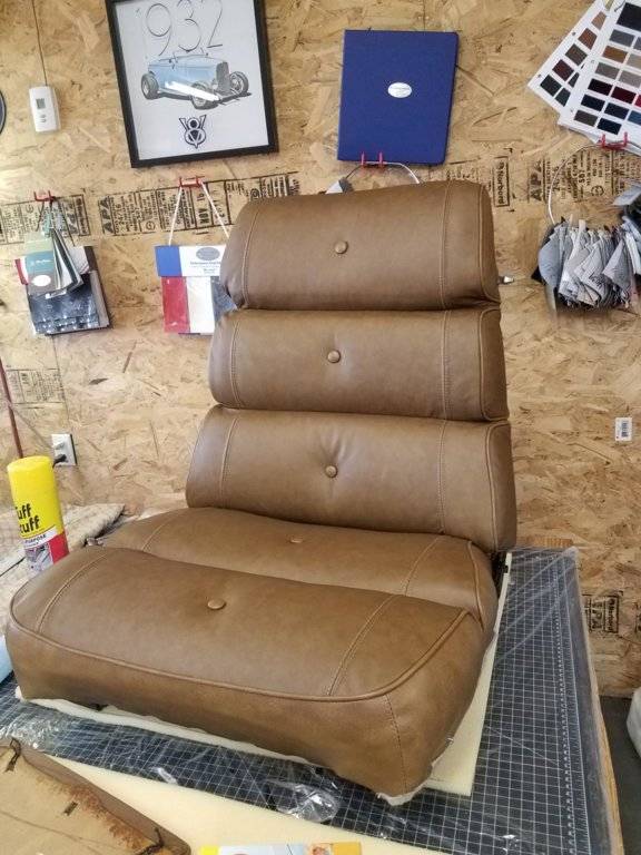

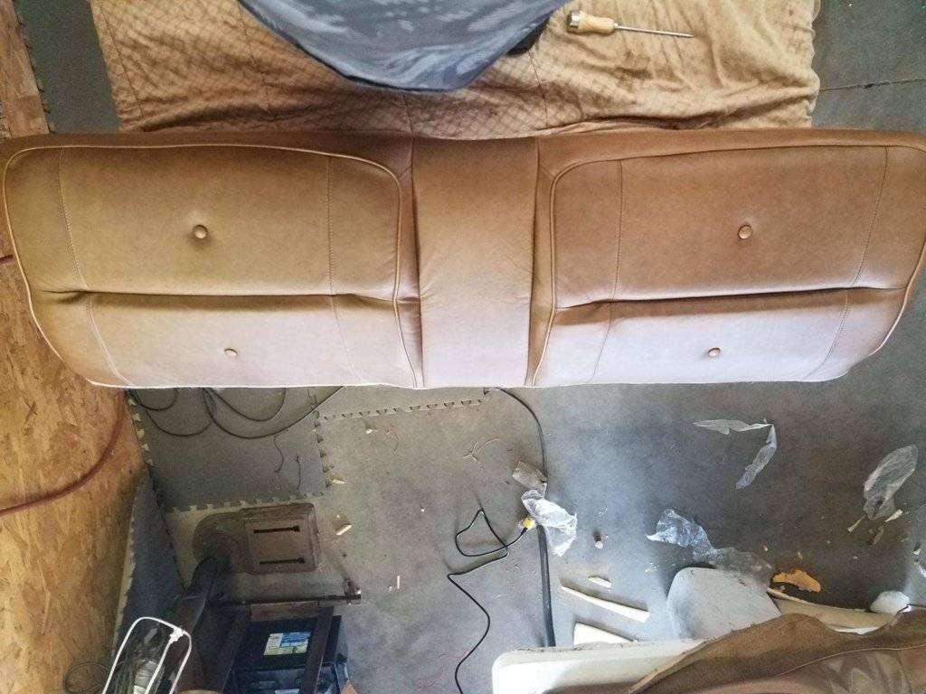

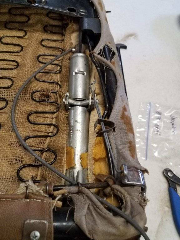

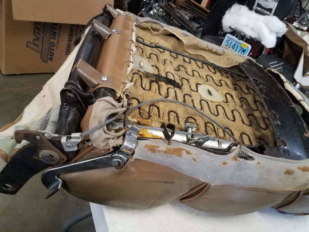

I’m in the midst of recovering my 300 Hurst seats. On the passenger side is a device that looks like a piston. Not sure what it’s function is. Is it to adjust backrest? If so it doesn’t work. Any recommendations on where to get it rebuilt along with seat motor? I posted a few pics of it and seats below
To me it looks like the reclining seat back mechanism, so when you pull the chromed lever up, the seat back may be pushed rearwards to the desired position.
I have no information about where it could be rebuilt.
PS, where are the head rests?
There's not much to that reclining device. It's just a rod inside a tube and a catch. When you pull the lever, the rod can move and when you release the lever, the catch is supposed to hold the rod in position. It would probably be hard to test it with the seat disassembled.
Isn't there a spring inside the piston, too? To aid moving the seat back back up again (if the lever is pulled)?
The FSM has an exploded view of the seat mechanism that might help.

Thanks everyone. My upholstery guy is going to reassemble it to make sure it works. He didn’t see it until it was tore down and wasn’t sure how it worked.

View attachment 310074 View attachment 310075 View attachment 310076 View attachment 310077 View attachment 310078 View attachment 310079 View attachment 310080 View attachment 310074 View attachment 310075 I’m in the midst of recovering my 300 Hurst seats. On the passenger side is a device that looks like a piston. Not sure what it’s function is. Is it to adjust backrest? If so it doesn’t work. Any recommendations on where to get it rebuilt along with seat motor? I posted a few pics of it and seats below
