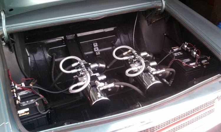

It’s easy to add hydraulics (juice) to a C Body. Hydraulic cylinder goes where the shocks go w/ a power ball welded to the LCA. Your setup is almost bolt on for juice. Expect to raise the transmission tunnel so the driveline doesn’t rub but you really need to do that to any car you juice. Torsion bars stay in place but the adjusters are removed. You’ll need to reinforce parts of the frame. It won’t be able to hop but perhaps with subframe connectors do side to side. 4 link rear is ideal.
I’m a lowrider guy, you build your car how YOU like it. My 68 New Yorker is going to be juiced. My friend Chris Anders juiced his the same as I just said. It is way easier to juice a C Body than to bag one. You can even add accumulators for a VERY smooth ride close to stock. People hate to see it, but a style is a style and we have to respect everyone’s builds. I love C Bodies in all shapes and sizes! I just happen to like mine riding low :)

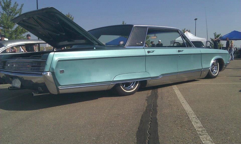

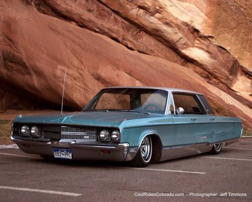

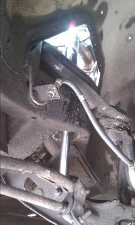

View attachment 539735View attachment 539736View attachment 539732View attachment 539734View attachment 539733
Veryyyy niceeee - looks really good

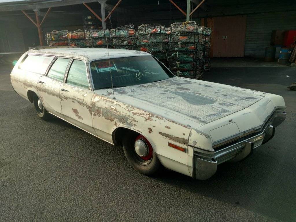

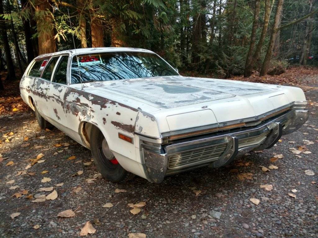

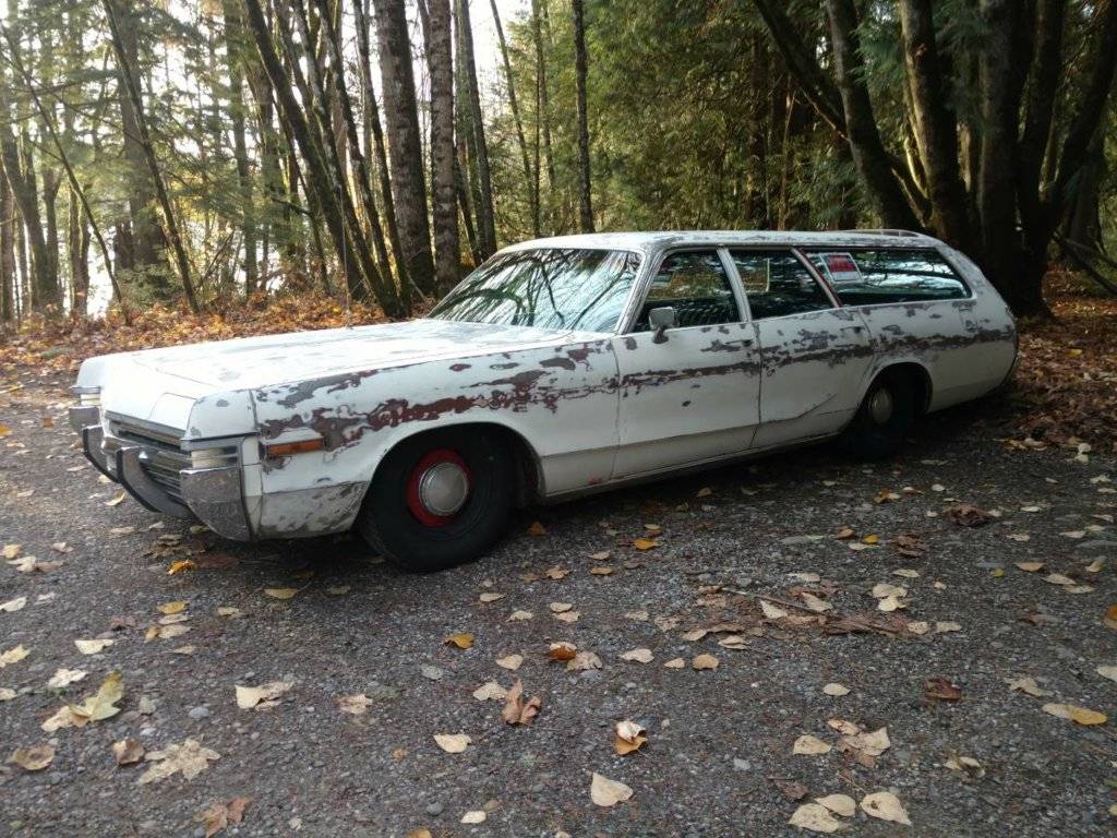

The previous owner of my white 72 used blocks in the rear and adjusted the torsion bars so it sat low. These pics are from the sales post when I purchased it. Eventually I put it back to the proper height because the ride quality was really poor. It kept bottoming out on the bump stops, and the front tires wore badly. I admit that it looked neat.

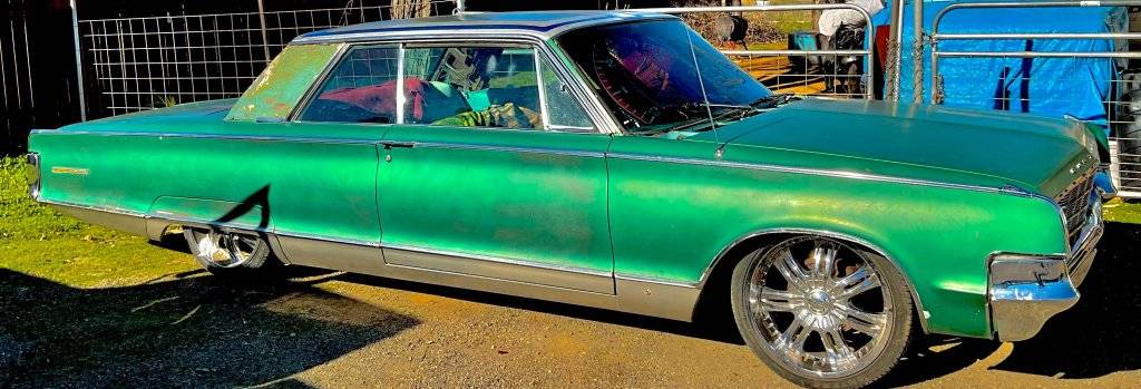

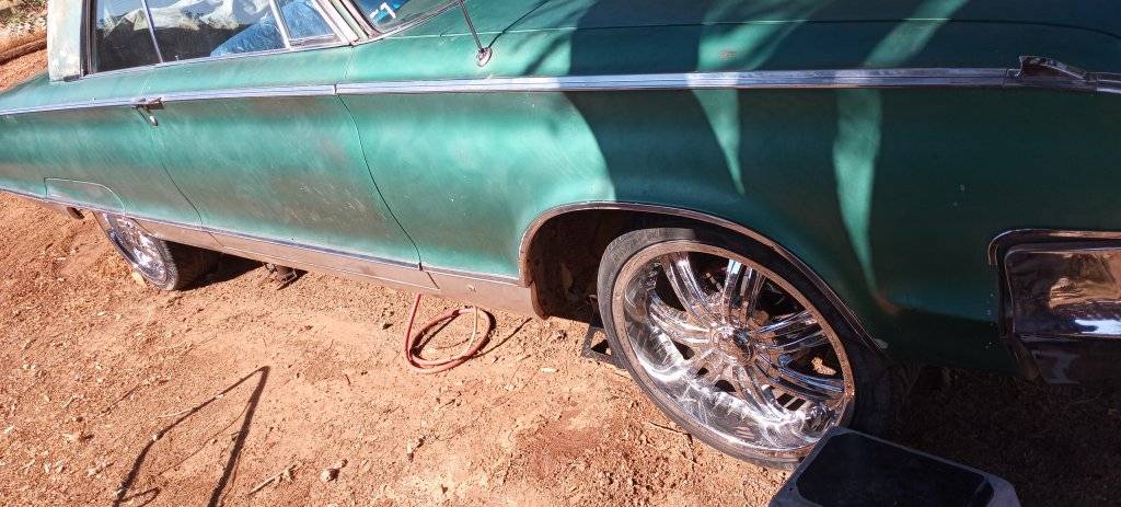

Did this with no hydraulics
