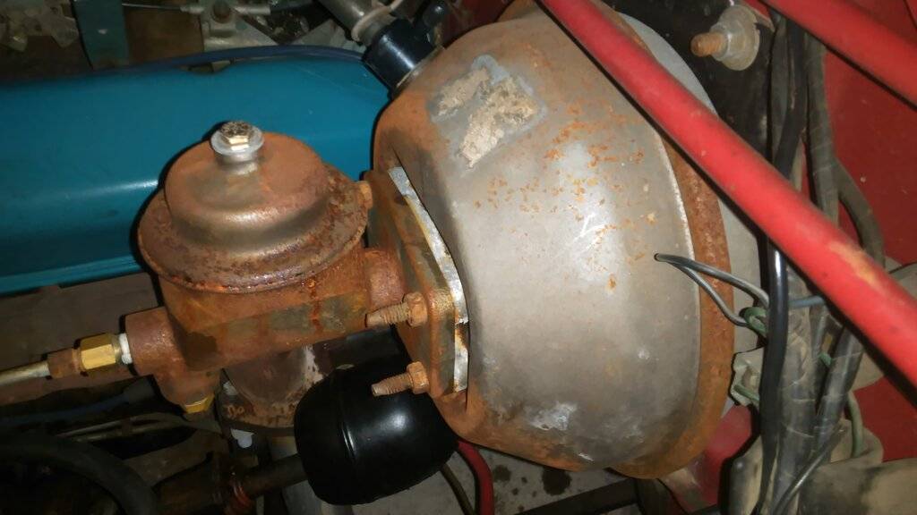

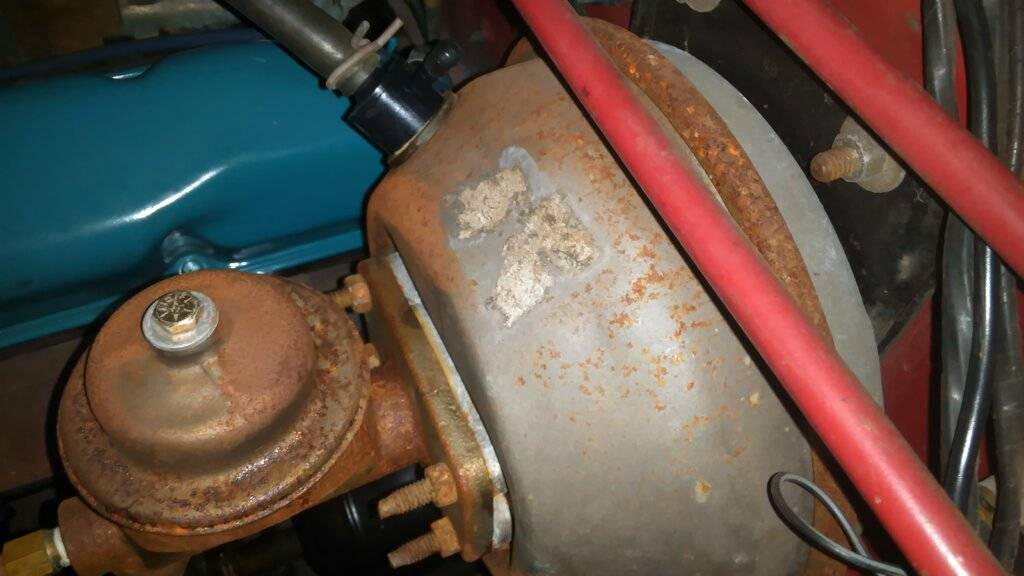

I think I found the problem...
I could hear a hiss around the vacuum booster after driving the car. So I sprayed around the booster with carb cleaner and got a hit when I sprayed around the gasket between the booster and the master cylinder.
The FSM shows some kind of spacer/retainer with a filter in it. And it looks like there's one in place but perhaps the spacer has degraded enough that it's causing a vacuum leak. This would explain the driveability issues and hard brake pedal I have.
Pictures below...

I didn't hear any hissing inside the car. It was all on the outside under the hood and quite loud, like not running an air cleaner at idle loud. My brake light switch stays on all the time now, it never did that before either.
