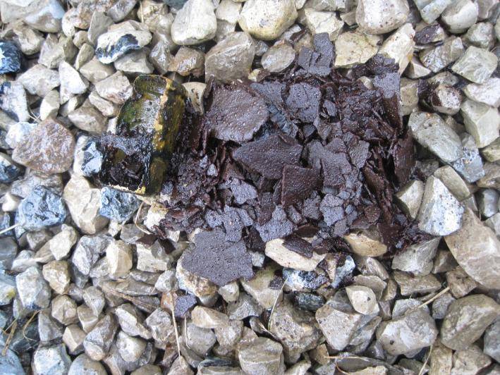

I removed my fuel tank to have it reconditioned. There was just a few ounces of liquid left in the tank. I dumped it out and I discovered that I will definitely need a new sending unit. Notice in the first picture the pile of rust and a half eaten float.
I was surprised when I removed the pad on top of the tank how clean it was.

Ordinarily I don't recommend "reconditioning" fuel tanks. You can spend money and time on it with no guarantee of success, and a botched liqui-liner can make things even worse. Judging by the size of the flakes in that pic there could be some very thin spots in that metal. Check it real carefully before proceeding. Investing in a new tank is the best long term solution.

Thanks I'll check out the cost of a new tank. I was surprised by the big rust chunks. I have a great radiator shop that has been around for over 50 years. They will tell me if I am wasting my money or if they can't guarantee the work. I have been dealing with them for years.

The top of the outside of the tank should be near perfect, it is out of the elements. It is what is inside that counts. I had my local radiator guy do a repair on my tank, cost fifty bucks, that was 8 years ago.

That was my next question thanks for the info. I'll still have my radiator shop take a look at it. I'm hoping they think it's salvageable.
No one is reproducing the tanks for '65/'66 at this time. I had mine flushed and lined at a local radiator shop. There were pin hole in the top that were properly repaired. I haven't had any issues since.

After an extensive on-line search I came to that conclusion. Thanks for answering my next question before I asked it. I trust my shop to do the best possible work on the tank.

I dropped the tank off. He said if a new tank was available he would have leaned to recommending me to buy one. I can't remember the name of the product he said the the tank will be coated in but he said it looks candy apple red when it's done. The good thing is if the tank ends up not holding up, the process is reversible. The reversible process allows the tank to be completely renewed with a lifetime warranty. He has seen tanks much worse than mine renew by the other process but it cost over $400.
