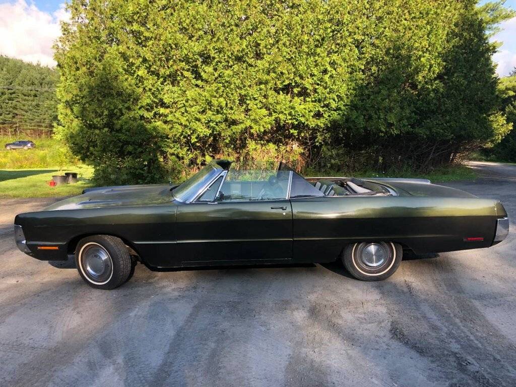

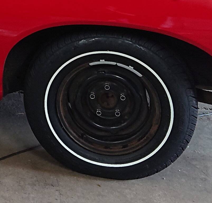

Sometimes the balance weights are set right to the lip where the wheelcover edge meets the rims (see my picture). It will sit tight but nut properly at that spot. That´s why I check mine every once in a while but never had issues so far.
Weird situation you had. The radial tires may be an explanation but on the picture you uploaded it seems that there´s a half inch gap between
the rubber and the wheelcovers. The tires don´t wobble that much to pry the covers off over that distance. I say it´s the wheelcovers` hooks... They have to bite into the rim. Screw the paint, no one cares about the paint of a steel wheel that covered anyways. Look at mine, you see the marks where the hooks scratch into the paint.
I usually punch them on with my fist. That way you don´t dents and you hear when they are sitting tight.
If you need THAT much wieght on the wheel,replace it or find a better place that can balance them properly.
I have been in the tire business over 30 years and this is really unacceptable IMHO.
found these on ebay .. they´re half a century old. the tire place told me they´re horrible but they tried their best to balance them.
still better than reproduction Chinese crap...
Gotchya..old tires.
They can fail without warning and can do damage to the car..just sayin..
Gotchya..old tires.
nah the tires are brand new, the rims are original ones. I don´t know the year 1965-1973 range.
But still I trust old American steel more than new Chinese trash. And the weights do their job,
no shaking steering wheel from 0 to 80 mph.
How's the other side look, any weights?
