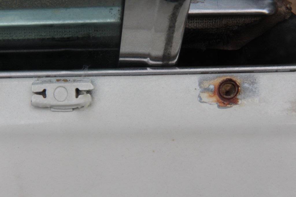

And have not found them, or a suitable substitute.
They hold narrow trim strips outside of the windows on my 1965 Plymouth Fury III.
They measure about 18mm long and 7mm wide. In the photo, you can see one intact, and another broken off with the peg inside the hole.

Put "3d print" in the search box. There may be someone here that can make you some using one of your originals as a pattern. I have seen that done on the A and B Body forums.

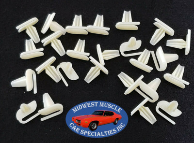

I used these in place of the original style on a narrow vinyl top molding. Worked great and fit right in the existing hole.
