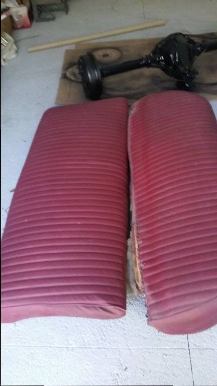

Can anyone tell just by looking what my seats may be from? The rear seat is where I have a problem, the back of the seat sticks up about 3" higher than the package tray shelf.I don't think this is right?

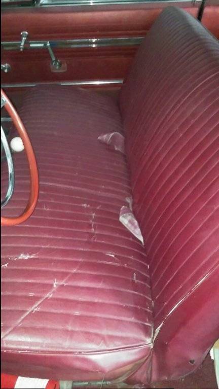

Hard to tell from the pics what these seats are, esp with the generic covers on them.
Based on the doorpanels, is this a 66 Sport Fury, or the car in your avatar?
If an SF, should be buckets in front of course, and a divot in the top of the rear seat for the sculpted package shelf cover.
If not an SF -
Is the front seat a split-back for a 2dr? Can't quite tell in the pic. If not, it's gotta be wrong.

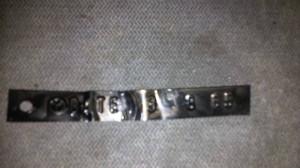

That is a great idea. I looked under the rear seat sitting on the garage floor, only found a tag that said "3-65 production date". So that narrows it down to a 65 model something.

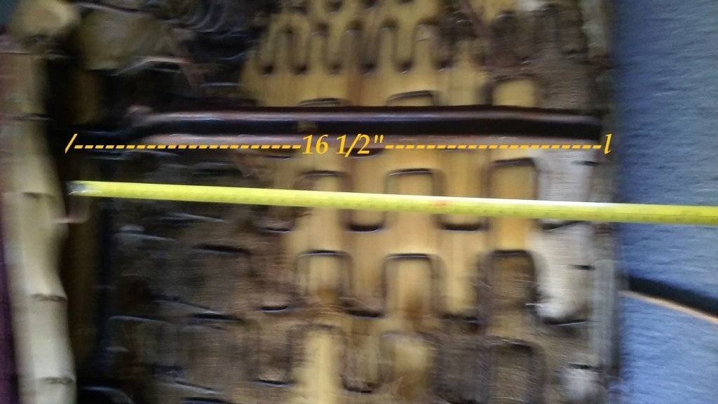

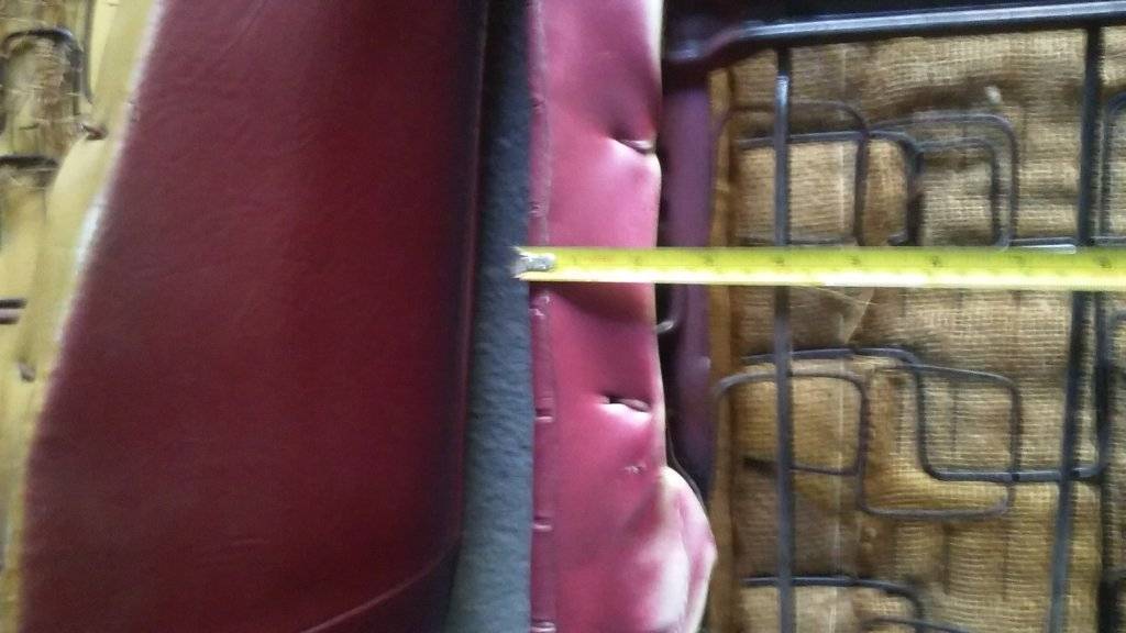

The hook in the seat that engages in the floor is 16 1/2" to the rear of the seat.

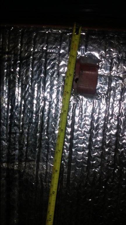

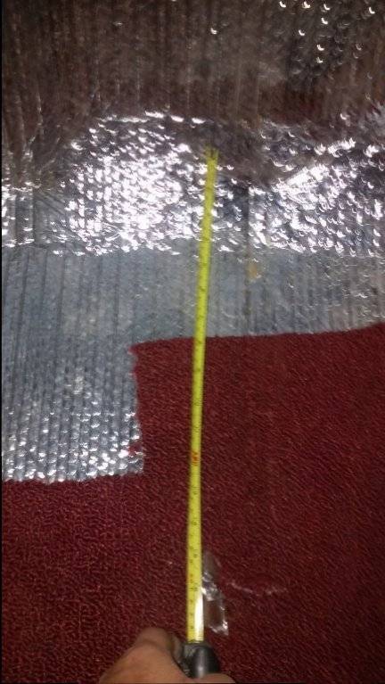

The back of the bottom seat is riding up on the 'bump' in the floor.It's hard to see from the picture. The measurement is 16 1/2". If you look closely, there is an indent in the foil.
The seat back is actually being held up by the bottom cushion, riding up on the bump. My guess would be that the seats are from a larger C body,that had more room before the bump protrudes up.
I think I'll try welding some extensions on the rear seat bottom and move it forward. At this point, it isn't going to hurt anything.

Yea if that's the case, this seat bottom is about 3-4 inches too deep. It barely fits without the seat back in.

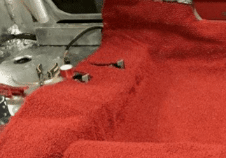

My Polara has 2 sets of brackets from the factory.
I had to transplant a pair from the original floor pan into the new to me floor pan
I'm posting this in case you are trying to connect the wire frame to the wrong bracket.
The set I had to transplant were just behind the edge of the vertical pan.
Wow that's odd. So I just went out and measured my bracket, it is 4" from the most forward edge to the floor drop off. Your most forward looks closer than that. Go figure.
that is true.
the floor for my current installation came out of a 65 Fury and it only had a pair of brackets like you have.
So which bracket do you use, the forward one correct? So that would mean Polara seats are deeper than the Fury's? Am I understanding that correctly?

not sure, I had to use the forward brackets to hold my seat down.

The floor pans are identical other than the filler panel between the rear frame section(where the rear passenger sits their butt down on) and the main floor pan is longer by 3".
The rear frame rails, trunk pan and hump are identical with a few brackets being spot welded into slightly different locations or a different bracket is used.
I had to choose between moving the front spring pockets forward on the new rails up by 3 " because the Polara springs are 3" longer than the Fury
I could have used Fury leaf springs but I didn't want to buy new shorter springs
I just discovered the other day that the lower brackets where the back of the seat bolts up to was shorter in depth by about 1&1/2" so I had to transplant my original brackets into the floor hump to fix this problem
If I had no then I would have had a big gap between the passenger seat and back rest
In fact I left the original Fury brackets in place ans imply riveted the Polara brackets over top since they were in the correct position in the floor pan already.
