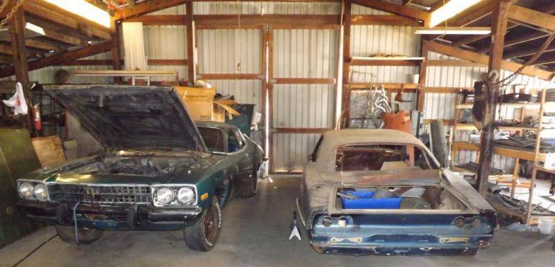

I know its not a c-body but....

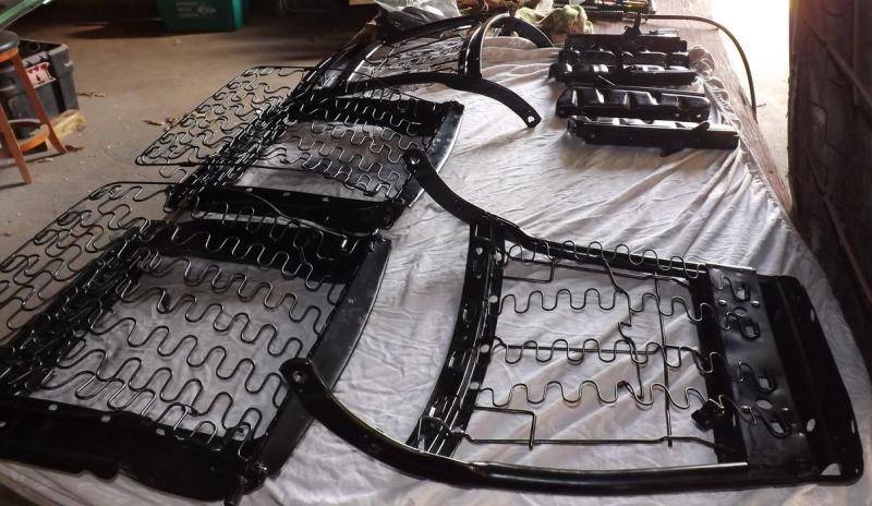

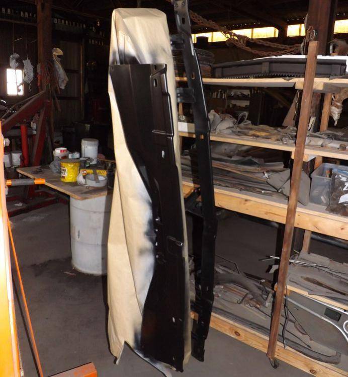

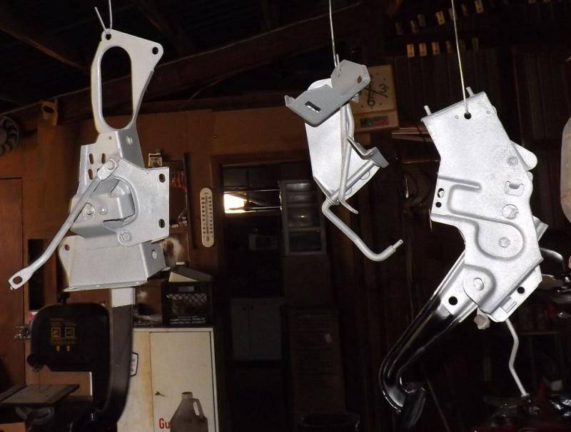

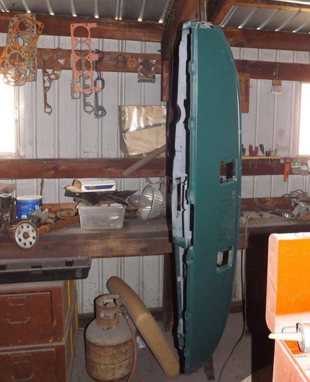

Okay, some updates here wth more to come later this evening, check the pics. They are self explanatory.

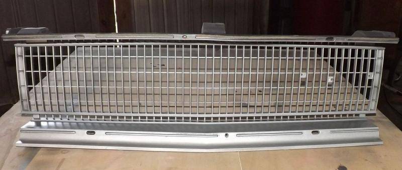

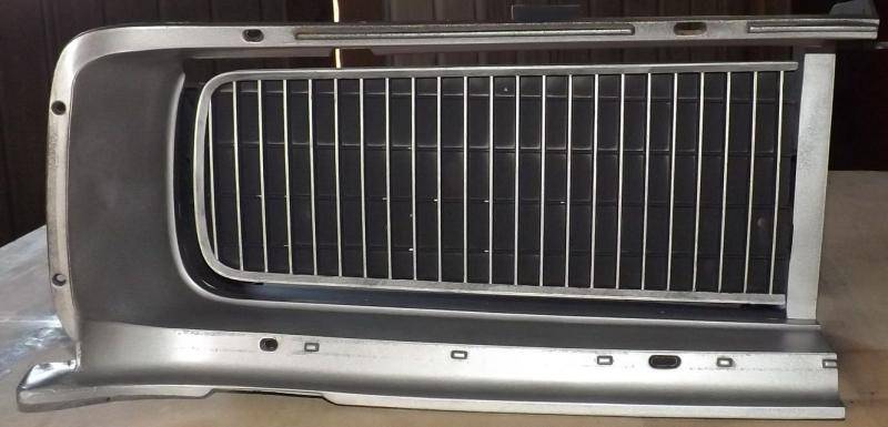

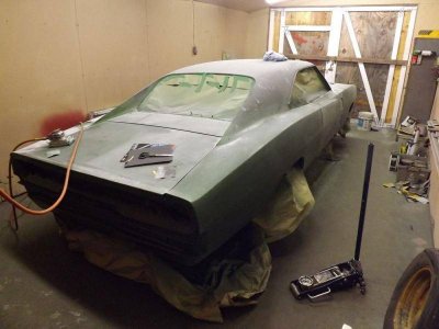

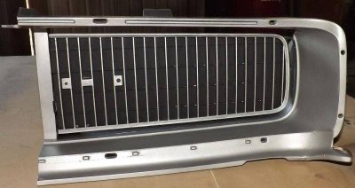

Alrighty, here are some more pics, the grille had holes in it so I had to repair that, if you look front and back, you wont pick it. I'm very happy with that. :)repaired grille.jpggrille center5.jpggrille ps.jpggrille ds.jpgcharger in paintbooth.jpg
