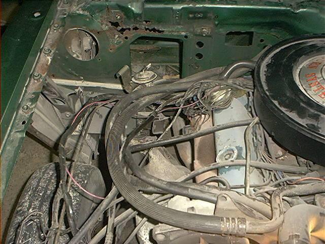

3. The upper cowl/firewall area. Even you, Nick, can't repair that area.

Oh, and the cowl can be fixed...trust me.

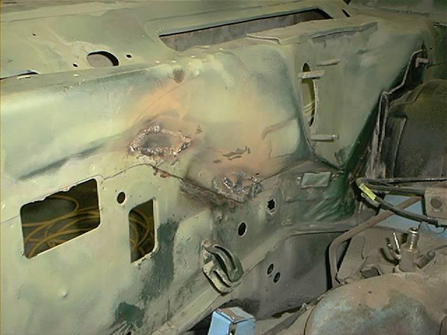

If it's like that, yes. But your inner cowl was still solid, right?
Nope, Although this pic is of the engine side, I had equivalent patches inside too. The contortions to get under there...
