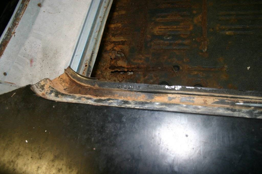

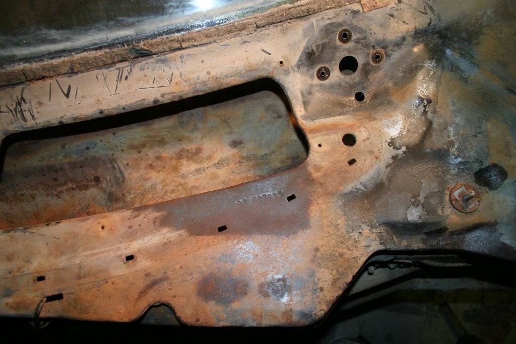

In 68 the hidden numbers are not the VIN, likewise the VIN is not on the data TAG.
The hidden numbers will reflect the number that is on the data tag.
One of the numbers is under the weatherstrip by the left side trunk hinge
The other is under the cowl screen/hood seal near the left side.
Alan
Alan

Paint and or rust can easily fill them in, on this one (a 69) the cowl one was not detectable at all till I took a wire brush to it. The trunk one may have adhesive hiding it.
Alan
Alan

In 68 these are the SO number and not the VIN.
In 68 the VIN is NOT stamped anywhere else on the car.

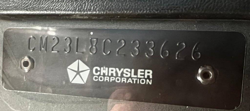

L code on the vin designates that this is a TNT 375 horse power 440 equipped car

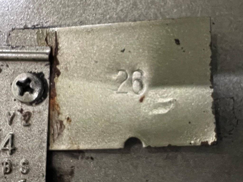

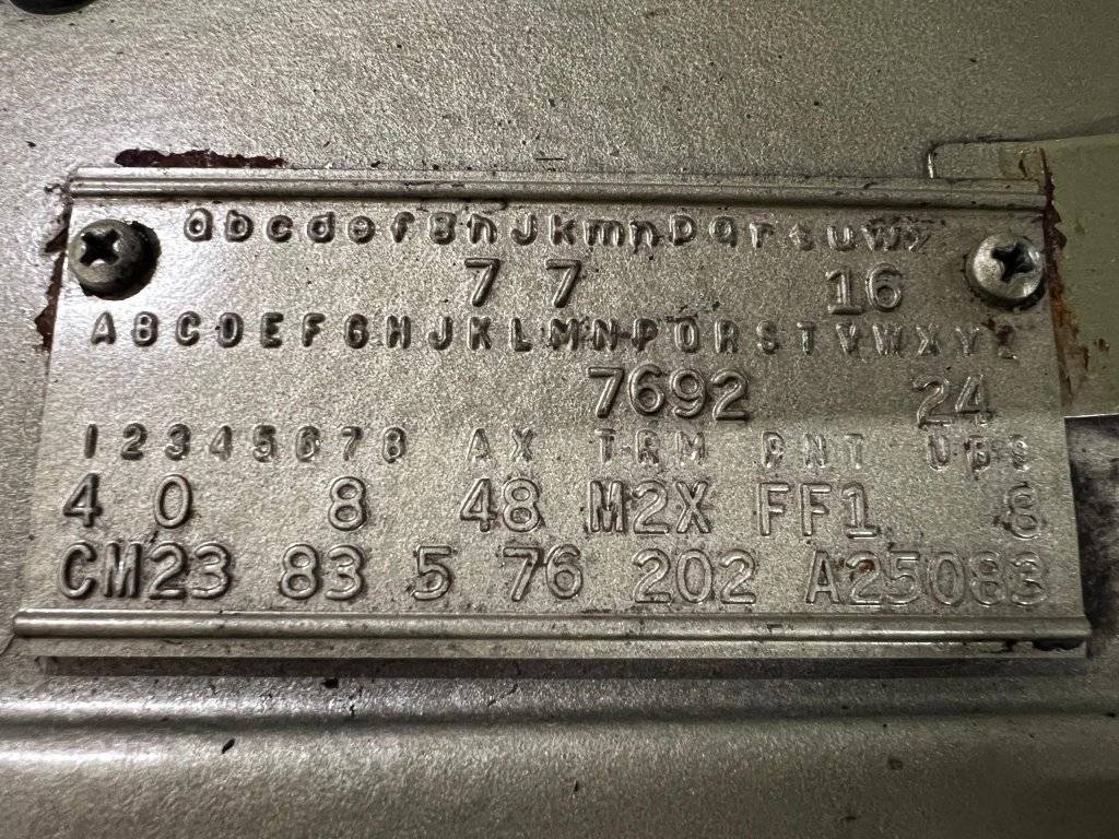

The L in the VIN and the 83 on the fender tag tell us this is the TNT 375 horse engine.
The 26 on the small tag is simply an inspection stamp. Somebody did their job, inspected something and punched the tag.
The purpose of the fender tag is a durable traveling marker so different people involved with the assembly know, generally, what paint, trim, brackets and holes need to be punched in the body. It also contains administrative identification numbers such as the Scheduled production date (202) and the remainder of the Sales Order (SO) number A25083. The SO starts with the letter A telling us the car was originally built for sale in Canada.
The numbers under the various letters help identify certain sales codes as to items that were on the car. Not all options are recored on the tag, Generally, again, only the options or moldings that require holes or brackets attached to the bare body are listed.

From your VIN:
CM = 1968 Chrysler 300
23 = Body, 2 door hardtop
L = Engine, 440 HP (TNT)
8 = Year, 1968
C = Production plant, Jefferson
233626 = Unique sequence number to car
From your data tag:
h7 = Fender mounted turn signal indicators
k7 = Passenger mirror
u1 = Sold car when built (someone ordered it)
w6 = Build to specs for Canada
N7 =
P6 = Rear seat speaker
Q9 =
R2 = Music master AM radio
X2 = Tinted windshield only
Y4 = Green vinyl top
1-4 = Sill moldings
3-0 = Body belt moldings
7-8 = Wheel lip moldings
AX-48 = 3.23 with sure grip
TRM M2X = Black cloth & vinyl bench seat
PNT FF1 = Frost Green Metallic
UBS 8 = Stripe delete
CM23 = 1968 Chrysler 300 2 door hardtop
83 = 440 HP (TNT)
5 = 3-speed automatic transmission
76 = 8.45x15 whitewalls
202 = Build date, February 2, 1968
A25083 = Unique sequence number to car
Hopefully, someone can fill in the few gaps and verify what I have.

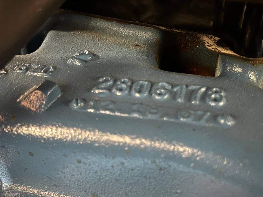

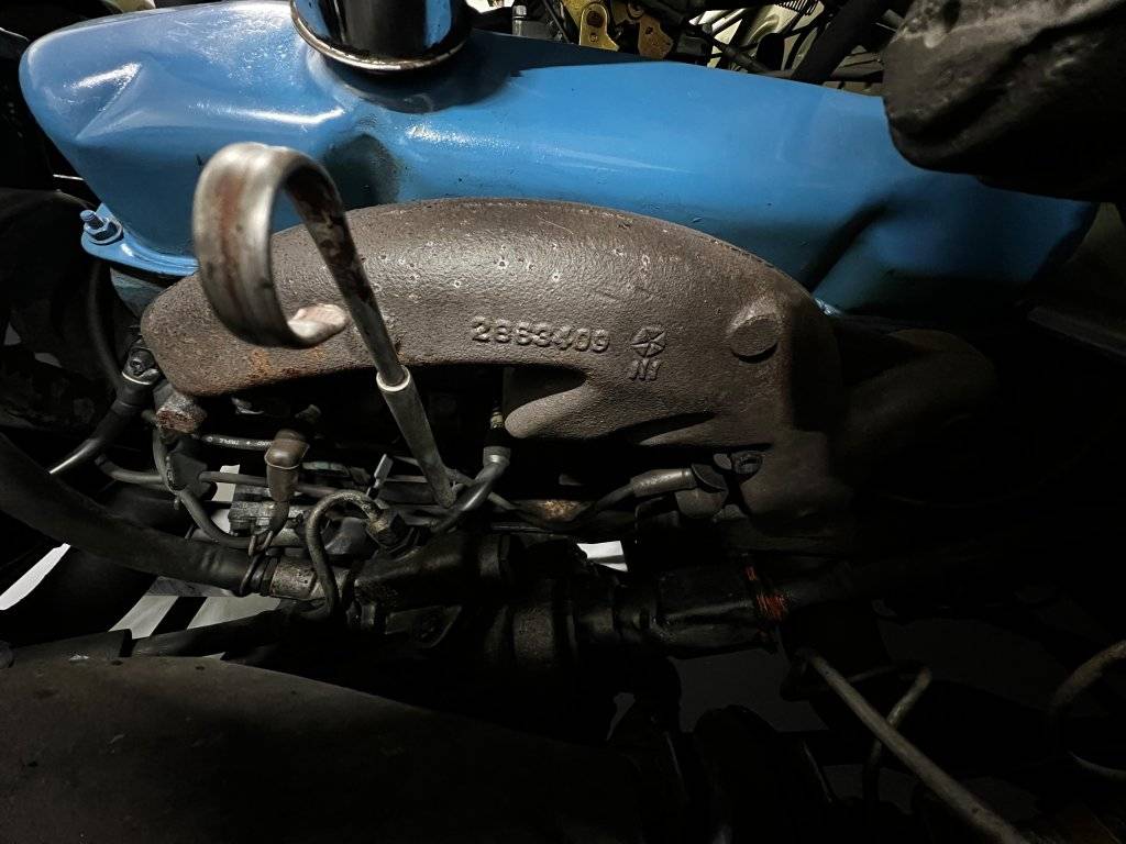

The exhaust manifold you show looks to be the correct one for the TNT car. The advice on where to look for the sequence number is also correct. This number should match the sequence number from your data plate.
In '68, they started stamping numbers on the motor and transmission. On my December-built TNT 300, they were both together at the top of the rear of the block and the transmission bell housing right next to each other at the top. I had to clean some grease to read them, but they matched the last part of the VIN. This would determine/prove if your car is "numbers matching".

I found the same thing for Q9 as well, but my '68 300 has that code with no Sentinel Lighting. This is how mine decoded:
b5 Folding arm rest (buddy seat), order code 485
h7 Fender mounted turn signal indicators
u1 Sold car when built (someone ordered it)
A1 26 in. radiator
D9 Front disc brakes
H2 Power locks
K8 Power windows
N8 Rear window defogger
P6 Rear seat speaker
Q9 Sentinel lighting
R2 Music master AM radio
S1 Air conditioning
X1 Tinted glass (all)
1 4 Sill mouldings
3 0 Body belt mouldings
7 8 Wheel lip mouldings
AX 48 3.23 rear axle ratio, sure grip
TRM M6X Vinyl bucket seats, black interior
PNT WW1 Polar white
UBS B Black horizontal stripe
CM23 1968 Chrysler 300 2 door hardtop
83 440 4bbl HP, 375 hp
5 3-speed automatic transmission
76 8.45x15 whitewalls
C07 Scheduled build date: December 07, 1967
Not represented above, but is on my car: Tilt/telescopic, headrests, reclining passenger seat, remote mirror, and day/night rear view mirror. Possibly power seat also, but I can't remember and the car isn't here to look at.
