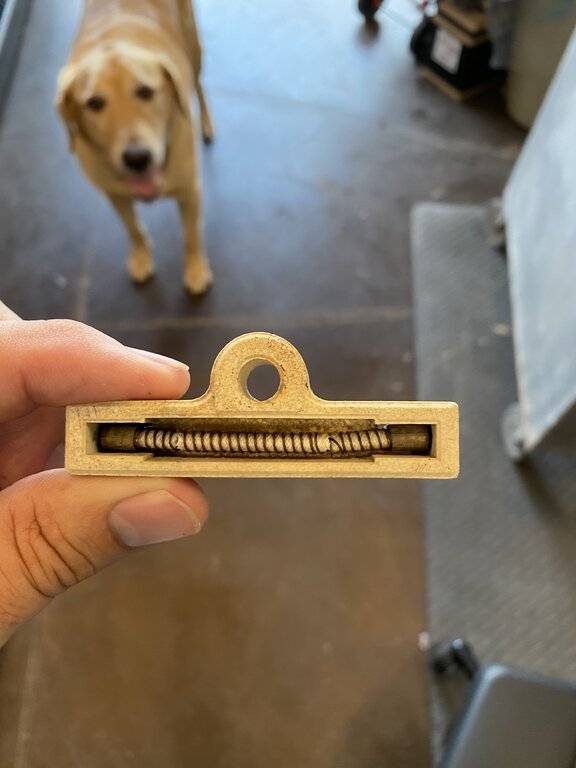

When I got home I took my multimeter to measure the voltage going through the ballast resistor. It was at 9.7 volts. Then it started missing and would drop to 9.3 on the miss. I didn’t think that was enough of a drop to cause the coil to miss fire. I decided to grab the FSM to look at the ballast resistor specs. No voltage specs, but current draw and ohms resistance. Resistance was supposed to be .5 -.6 ohms at 70–80 degrees. I was at 1.2 ohms resistance, more than double. I took it off the fender and this is what I found when I looked at my 1985 vintage ballast resistor.
Time for a new ballast resistor.
