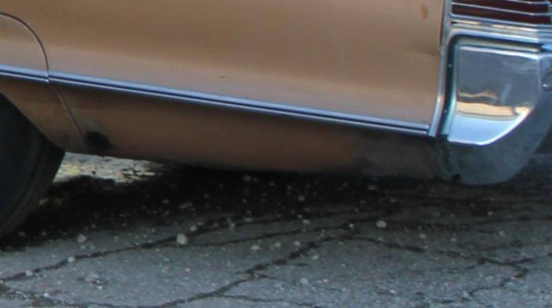

I have always wanted to do every aspect of a car restoration. The one thing I have never attempted was cutting out bad metal and welding in new. I am a decent MIG welder and have access to one. I realize it is a whole different animal, spot welding in thin gauge metal than welding some 1/4 in angle iron.
I was planning on getting some metal to practice on. Should I just buy some scrape from a junk yard? Are there any good books or DVDs to get me started? I have watched several you-tube videos so I basically know what I am getting myself into.
My goal is to repair the back fenders on my '66 300. It is nice and straight and the rust is not too consuming, but I haven't taken a sander to it yet to find out for sure.
Here is the driver side and the passenger side is a little worse.

Look around for some bodywork threads as you already did, and these minor spots are a good starting point. In general first attempts surely have a lot of room for improvements but one thing you can do right from the start is cutting out all of the weakened material, if inner reinforcements are rusted away you should cut as far up as to get to these panels as well.
Butt welding is best, for multi-layered components I'd recommend special primer that does not burn away or floats in these double layered areas. Just don't get to something like replacing larger parts of a frame rail or quarter panel f.e. in the first week :), there are some general rules when it comes to work in such areas, if you want to play "by the book", the manufacturers even gave you fixed rules as to where exactly you have to cut such parts to have proper stability and reaction to crash impact.
I'll try to get you some more detailed pics of the process shortly. The problem I see is that with the fender skirts you're going to have reverse curves on the flange. Not going to be real easy with just hand tools but I think you can do it. Hell my repair was the first time I'd ever worked wit metal.
