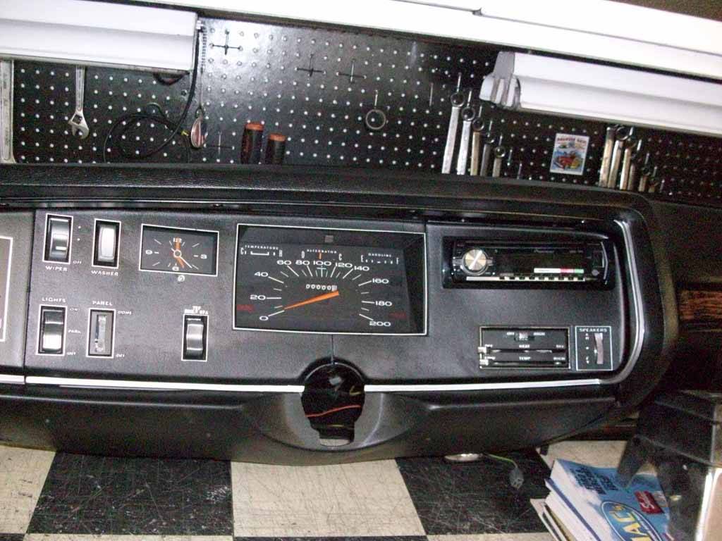

I replaced my AM radio with a Pioneer DEHX6500-BT with Blue Tooth, USB and a CD. It also has a removable faceplate and a little remote control. It fit without any cutting. Google Pioneer DEHX6500-BT for a ton of info and pictures. As I recall it was around $100 USD.

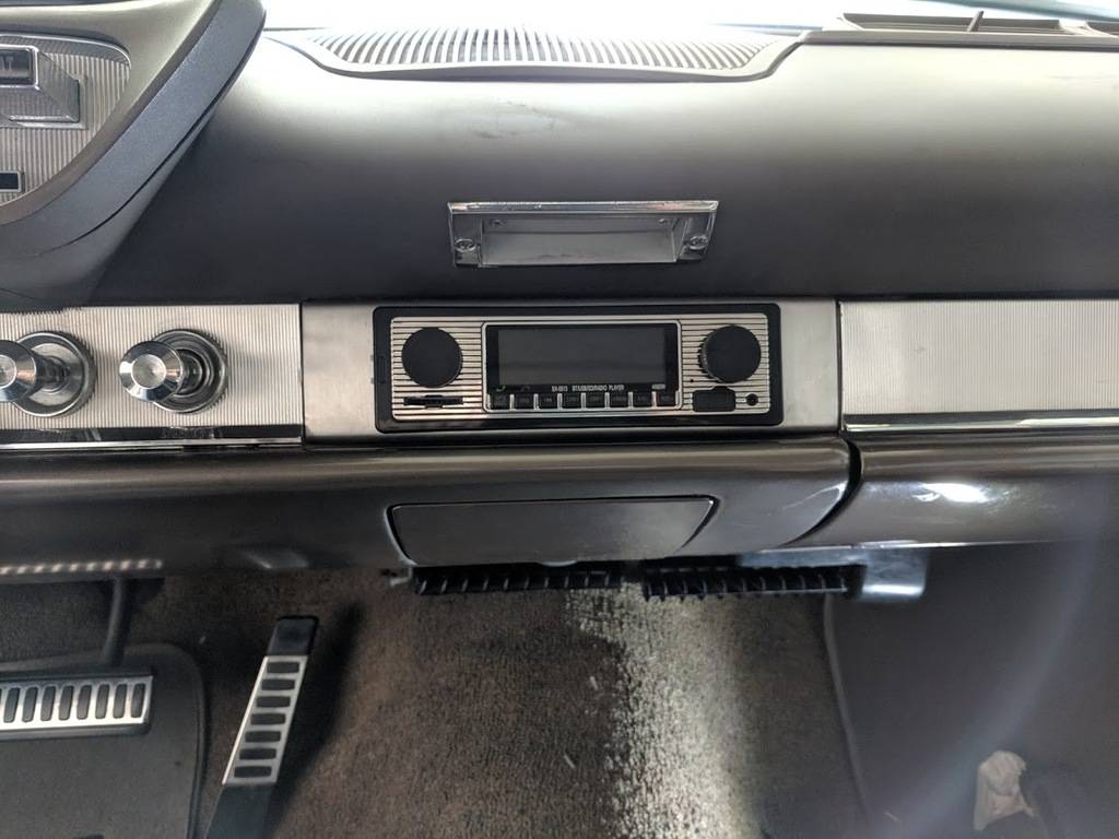

just bought Retro radio Redondo Rt (thumbwheels) to put in my 67 Newport, came on here to post about getting the ash tray mounting out as no one tells you how, I'll report back on the install & how it sounds.

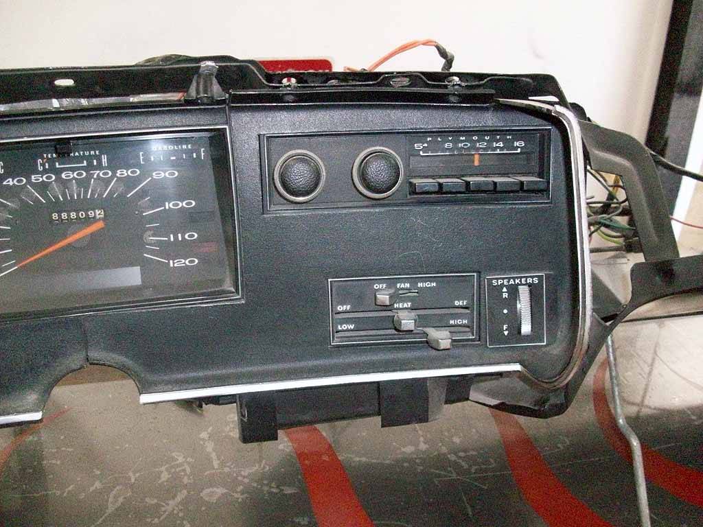

Problem with the '67-8 Chrysler inst pnl is that little "peak" in the middle, where the radio goes. Getting the orig radio converted would be the only way to get things to fit and look right, I believe.

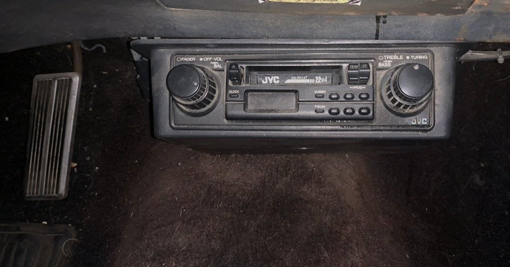

Not sure if they make an under dash box like this anymore but it’s a sturdy plastic surround for the state of the art circa 1985 radio.

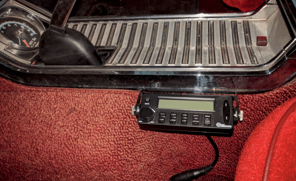

I have a Pioneer MVH-X580BS mounted in the trunk. Everything is controlled via Bluetooth through the ARC app on my phone, including a two-finger touch volume “knob.” Works pretty slick and I can put the phone on the windshield or dash with a cheapo magnet/suction mount.
