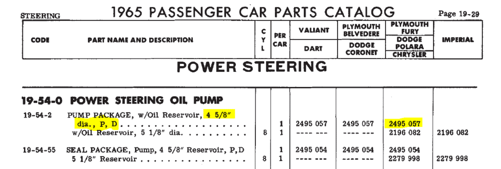

I have a part # 2537955 Federal power steering pump that I just purchased and wanted to know if it is correct for my 65 Sport Fury big block car? (383) I am scheduling an appointment to have it installed and want to be sure I am giving the mechanic the correct part. Thanks, Greg [email protected]

The part number you listed may very well work, it might be a superceded part number. Measure the pump diameter, and also compare where the bolt holes are. It wouldn't hurt to compare the pulley fits too(if your new pump didn't come with a pulley. If it all looks the same, it should work, but that isn't a guarantee.

Yes, I looked at my p/s pump that's on the car, same casting number, same mounting. Thanks for getting back to me, Getting Ol Sarge out today for a drive in Wi. Cheers, Greg
