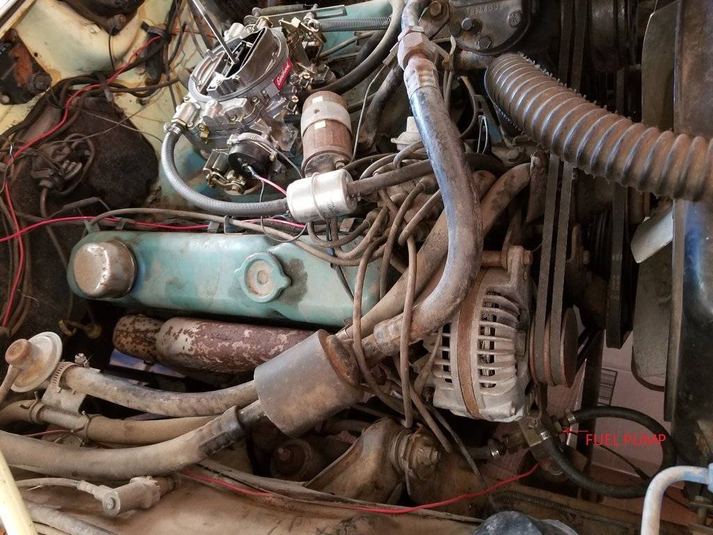

I was going to replace my fuel filter so I took a close look at my fuel line routing today. I think it is a mess. See picture below. I already know that the electric fuel pump should be relocated to near the tank and plan to do that. When I do, should I replace some of this hose with steel lines so it is more like the stock setup? It looks like the fuel filter was originally under the alternator and hard to get to. For now, is it OK to just replace the filter or this setup glaringly unsafe? I also noticed that the original fuel pump is still in place. Is that SOP when putting in an electric pump?
I can't really tell what type of electric fuel pump you are running from the photo. Most electric fuel pumps are the bellows type which do not live very long when mounted that far from the tank, the bellows is designed to push fuel not pull it. This far from the tank the bellows will rupture and the pump will be dead. The normal location for the fuel filter was behind the alternator which made it a pain to service. You fuel line routing should be fine as long as the extra length is not causing vapor locking problems. The stock fuel pump should have been removed when the electric one was installed along with its operating rod and the hole covered with a delete plate. This was what they call a quick and dirty fix to get the car running. The edelbrock carb that you are running would be more than adequately supplied with fuel by a stock fuel pump and that is what I would suggest you revert to. The are usually more reliable than the electric ones. If that is what you decide to do, try to find a Mopar, AC Delco or TRW fuel pump as they are still USA made and hold up a lot better than the after-market Chinese knockoffs. Also check to be sure some idiot did not draw power for the fuel pump from the coil circuit. That is a resistance circuit and it would be overloaded by the addition of an electric fuel pump, not to mention the fact that the fuel pump would not be getting full voltage to operate properly and the overload condition would produce low voltage to the coil and cause misfire problems.
I really like that suggestion and will do it. The electric fuel pump is powered by a wire going to an accessory section of the fuse box.

Some like electric fuel pumps and they have their place, but the factory pumps on Chryslers worked fine. The fuel filter DID mount between a short piece of fuel pipe coming out of the fuel pump, then the filter was pretty vertical, then a metal line went to the carb from there. At least with earlier fuels, it worked pretty good.
With an electric pump, you need ONLY the stock fuel pressure pump (5.5psi or so) to not overpower the needle and seat in the carb and not have any pressure issues with the normal rubber fuel lines.
As the vehicle has been sitting for a good while, you will probably need to remove the tank for a good rinse and check for rust. Might be necessary to add a fuel filter prior to the pump to catch any rust particles before they get to the fuel pump, plus the filter between the pump and engine. At least until you're confident the lines are all clean and such. A marine fuel filter, with different fittings on the end, can be found at WalMart, for example. A clear center section with a mesh filter element that can be disassembled and cleaned, if needed.
