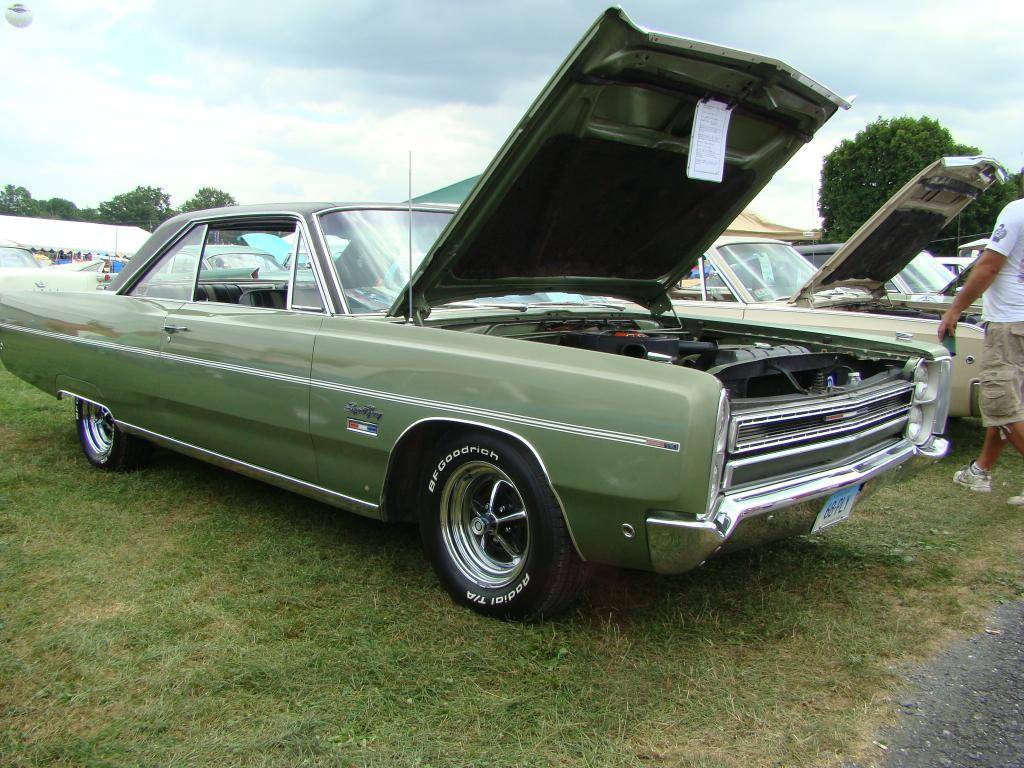

Another consideration is if you think you will convert to disc brakes some day you would need the 15" wheels. Here is a pic of my 68 Sporty Fury with the 15" Magnum 500 wheels.
