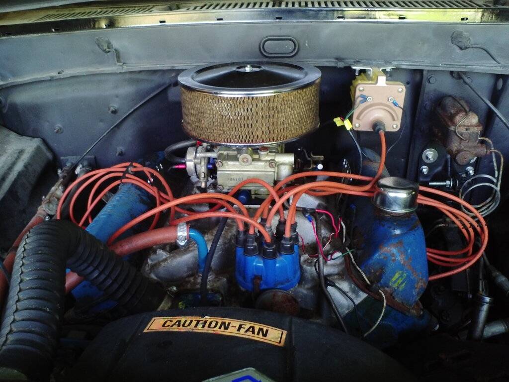

    I mounted, more like hung, my aftermarket coil on my firewall. Because of it's size there really wasn't anywhere to put it on my engine, not anywhere that I wanted to put it anyway.
    Not a Mopar and no trailer queen either, here's an engine pic. :D
    This is an old coil. It says "Made in USA" on it, so you know it's been many years since I installed it. It seems to work quite well up there. I've had no problems with it at all. That said, if I were to mount a newer coil these days, I would mount it upright somewhere so it couldn't leak. My experience with newer aftermarket coils on other vehicles has been oil leakage.
