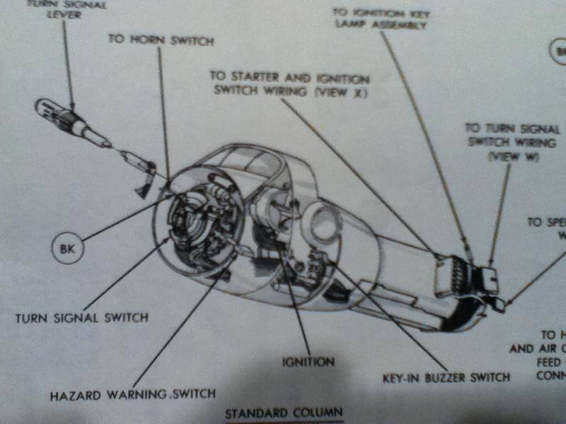

This afternoon I inserted my car key into the ignition cylinder on the steering column and noticed a slight delay or pause before the engine started. Long story short I think the cylinder is malfunctioning. Just to be sure I rigged a squeeze trigger switch across the starter relay: squeeze the trigger the motor fires right up without any delay starting. I wanted to be sure nothing was going on under the hood.
So what goes bad with this thing? I could not find an exploded view of an actual ignition cylinder. I guess this bugger is gonna have to come out of the column and replaced? I have a steering wheel puller to get the the steering wheel off....I never liked the one that came with the car so this might be a good excuse to replace it with one from a different model....New Yorker or 300 maybe. This happen to you? Comments?

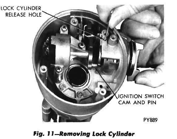

Re original question, the A-body forum has a great post on removing the column switch, with detailed photos that explain it much better than the factory manual. C-body columns might be similar.
